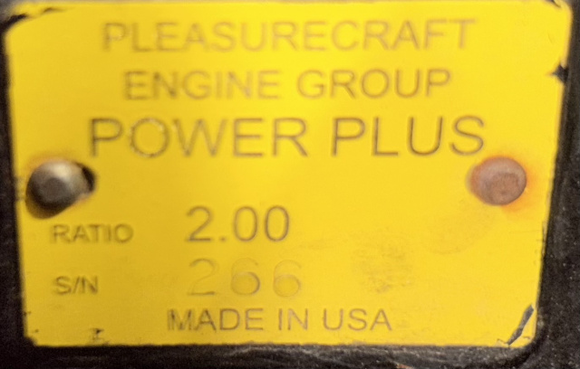

      Is this what you need to know? I couldn’t see a model number. Click image for larger version

        I don't recognize that as a transmission model. Is that on the transmission or on the v-drive gear unit?

          Sorry, I thought what I posted was it. The only reference I’m finding is that it’s a PCM V-Drive Transmission from the manual. Where would I find the model number?

            Oh, I failed to answer your question. What I posted must of been the V-drive. I was thinking the V-drive and the transmission were one unit given its name, V-drive Transmission. Thank you for your patience.

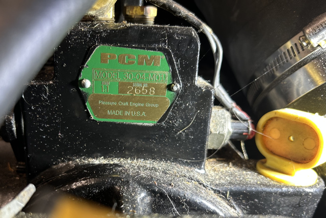

                  It appears to be a 30 series. Click image for larger version

                    That's an 80 Series transmission. So that's good news because parts are available. Don't ask me why what PCM refers to as the 80 series doesn't have an 80 in the model number....
