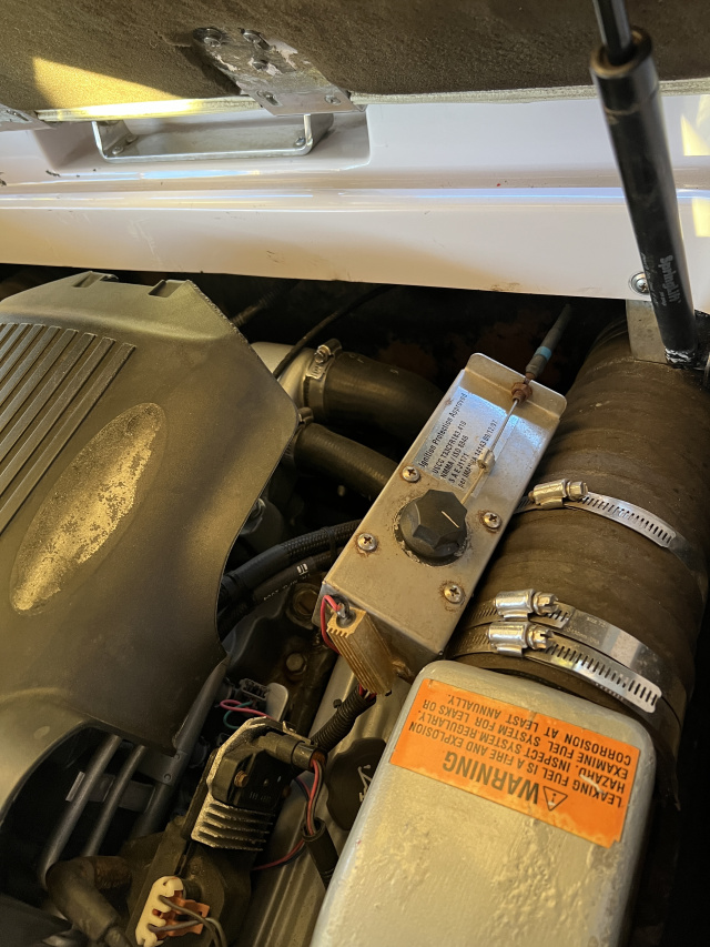

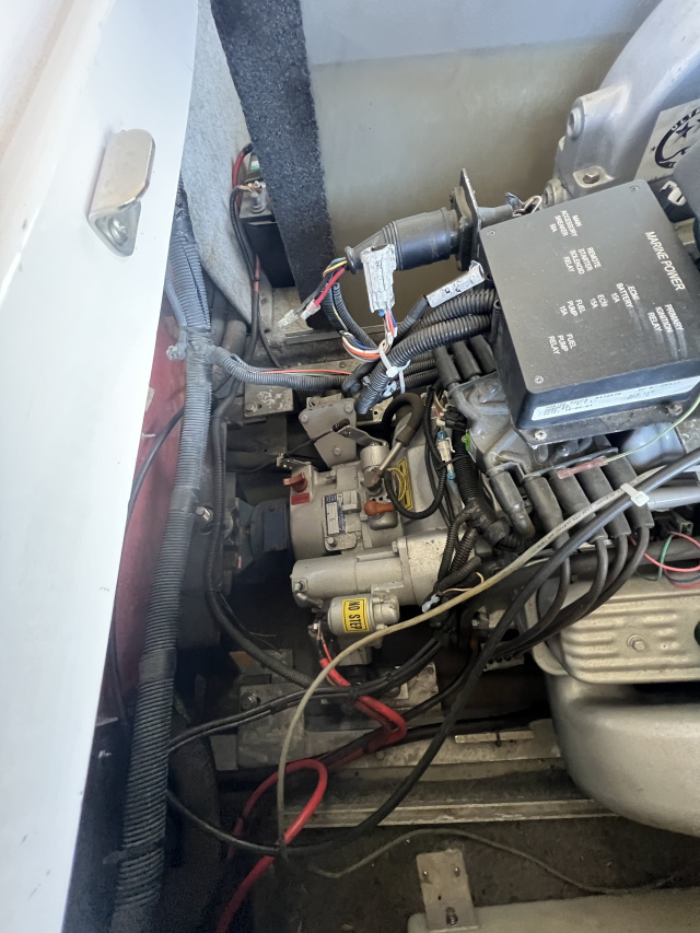

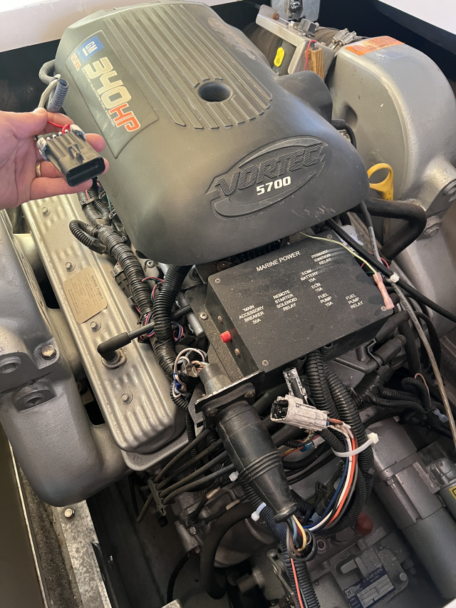

          Hey everyone! Thank you so much for your input! I'm attaching a few photos of the motor. I'm sorry I dont have all the answers!
          Regarding fuel lines, replacing them seems like a good idea anyways. I did remove the fuel and vent hose and blew through them and they seemed to have no blockage. I pulled out the pickup line and it seems almost new. Clean with the screen at the bottom. I haven't checked the return hose yet.
          When i first got the boat I took it to At The Helm Marine in Castaic CA where they did an overall service which included the Cap/rotor etc, as well as a new fuel filter.
          JPWhit - I hope you get some of those answers by seeing the motor. Please let me know if you need different photos. Your guys' help is very appreciated.

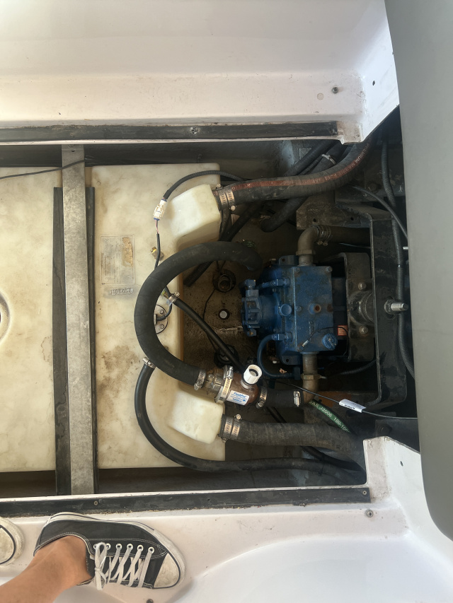

            Hi again. Here is the fuel setup. Really hoping anyone has more ideas! Thank you!

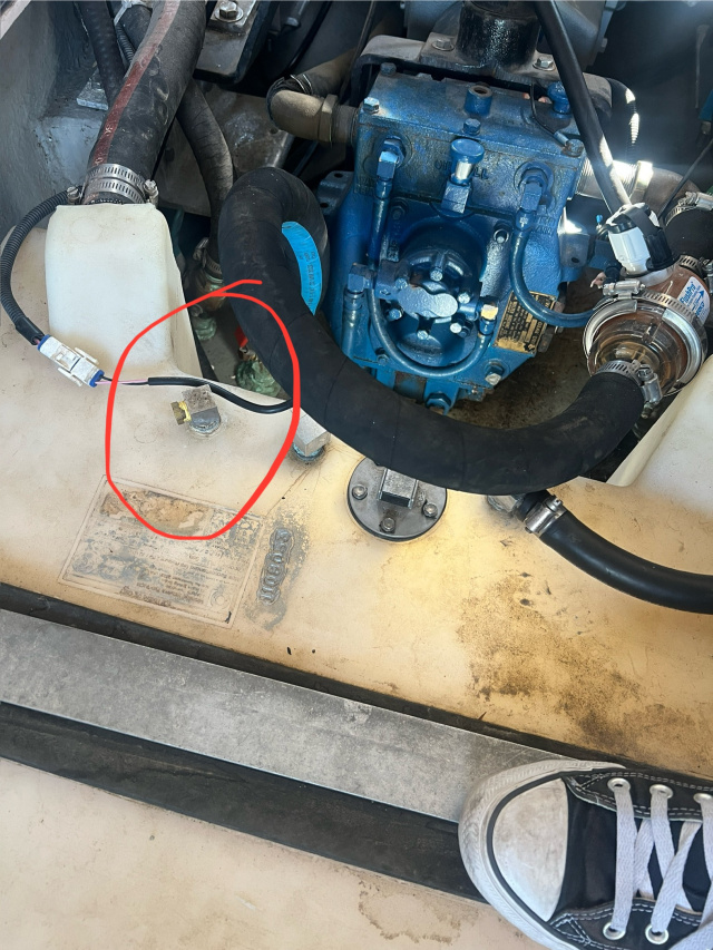

              Should there be a hose here, I see fuel pickup line, 2 fill lines, and one vent line. (And fuel sending unit.). Am I missing some sort of return? Any chance this can cause my bogging issue?

                It's not practical for me to figure out the fuel system topology from pictures. You would need to trace the fuel hoses and other components and identify all the fuel pickups, valves, filters, pumps, regulators, etc in the order that the fuel flows. You'll likely have to take some stuff apart to accomplish that. If that's not something you're comfortable doing, then you probably need to find a really good marine mechanic. Making an engine work well in a boat that's different from what it was intended, takes a pretty high level of skill and experience.
                Nobody can answer the question in your last post about that extra fuel connection on the tank without knowing the fuel system topology and the type of regulator(s) in the system.
