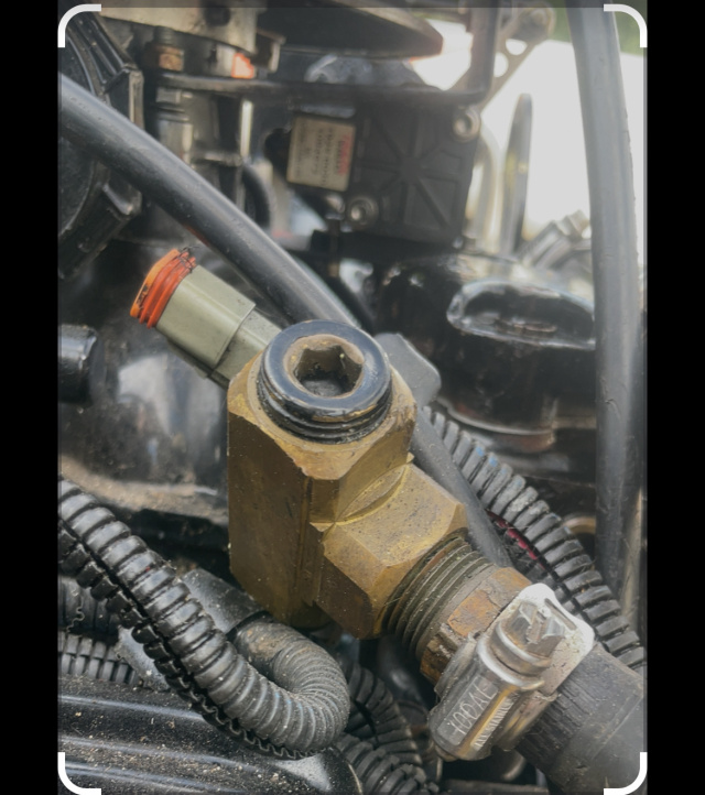

    Here’s a photo if anyone is interested

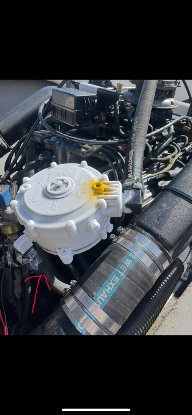

        So the way it works is that it takes the water that runs from the Lough, goes through the engine (heating it up) and then goes through the regulator to heat that up. I think if the water pump for that wasn’t working then the engine would overheat before the regulator becomes an issue.

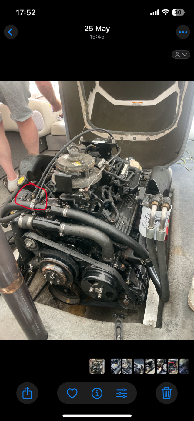

          Is that top hose the water line? I would feel the in & out lines see if they are warm, just like feeling hoses going to a car heater core. I assume there's not an additional pump pushing water to the regulator. Is there some kind of valve that regulates water flow through the regulator? I might start by unhooking the water line to the regulator and see what kind of flow you get. I am assuming this is not a closed cooling motor.
            that line is for fuel but there are 2 water flow in and out pipes. When it’s freezing up they are both cold. I don’t believe that there’s an additional pump for the water. I’m not sure if there’s a regulator for the water flow and unsure where to check. I’ll unhook the waterlines once she’s out of the water. Also it’s not closed cooling . Thanks for the reply!

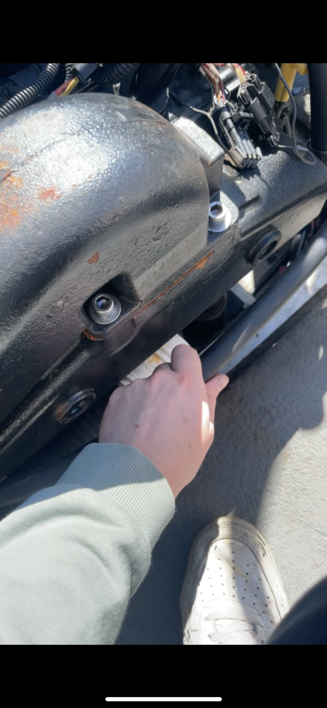

                They are all rubber lines, I have a few images to show where they go into the engine and the size etc. I’d agree that there could be a blockage but I don’t know if I should check while the boat is on the water. So far the boat can run for about 10minutes before losing all power.

                  You could run it on the trailer with a fake a lake hook up. Is the one you are holding off the ex manifold?
                  In your very 1st pic 1st post there's a blue solenoid? 180 degrees opposite the fuel line - what's for??

                    Hi mate. I took the pipes off and they did not have debris. Regulator was clear aswell. I was almost giving up for the day and decided to try turn boat on and give it 3000rpm. After 20 seconds went and checked regulator and it was finally getting hot. Unsure what the reasoning is for this. Would love to hear your insight. (In previous we’ve had days that were fine and other days it froze up) thanks
