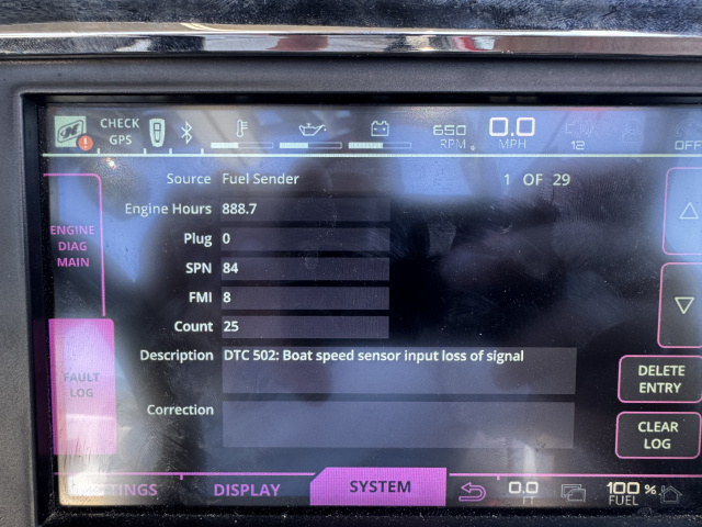

    Are you getting a message saying the GPS isn't found? If so, can you post a picture of that?

      just says check gps at top right of screen and no speed output.
      It does have continuity from the gps puck to the screen on both blue and white wires.
      Yesterday when I took the boat out I had no water temp or depth readings which was a first. so it probably is what you are mentioning.
      the only error code I’m getting is loss of speed input.

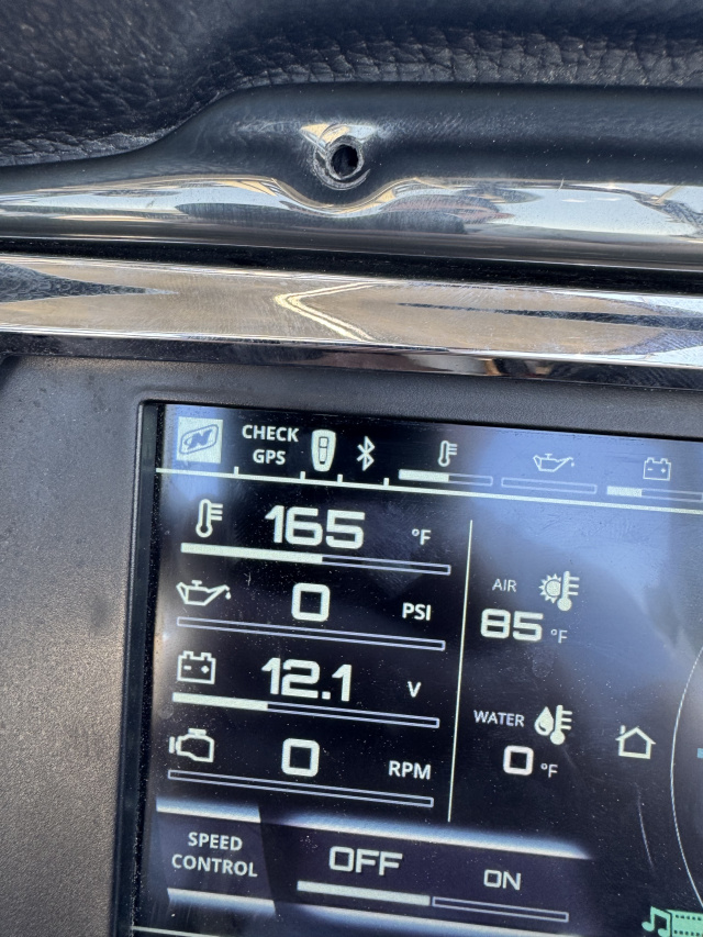

              During this latest testings were you getting RPMs, Water Temp and Depth, and other reading shown on the LINC screen when the appropriate sensors were connected? RPMs come from the engine ECU, so if you're not getting that and the engine is running, then clearly the engine ECM is working for the engine to run but is not able to transmit the engine RPMs over the CANBUS to the LINC screen. That would tell you the CANBUS isn't operating.

                No depth and no temp in any configuration. I do have rpm’s tho and seems accurate.
                I did take some pics if it helps. Engine was off that’s why rpm was 0.

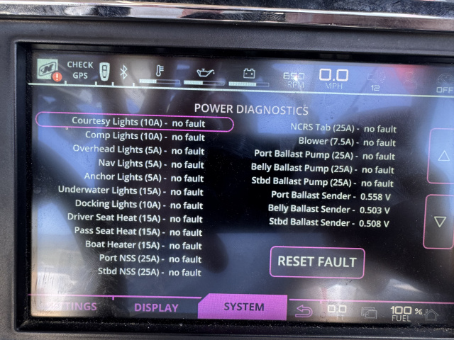

                        Should the ballast senders have a volt reading if they aren’t on? I noticed they show .5 volts but they weren’t switched on.

                            The ballast senders are just pressure sensors. I would expect they have a voltage between 0 and 5v based on pressure. They are always outputting a voltage, but the screen only "looks" at the reading when deciding when to turn the pumps off.
