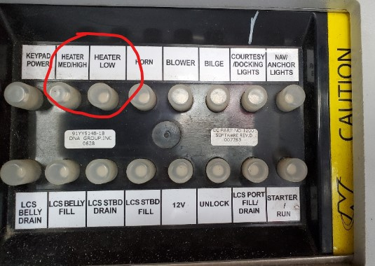

Check the circuit breakers. I ran into this situation a couple years ago, and on mine, there are two breakers for the heater--one covers low, and the other covers med/high (or something similar to that).

thanks MN Ryan, I will check my circuit breakers tonight, sounds like that would solve my problem!

10000lakes Did you check your breakers? This is what mine look like, and that would 100% explain your symptoms.
I will check my panel tonight.

My fan is working with MN Ryan’s help AND found exactly where Aeasson said it was.
I couldn’t have done it without your help.
