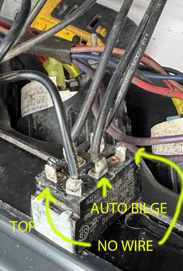

    Does anyone have the wiring diagram for the main power toggle switch on a 2008 Super Air? I was having the interior panel replaced, and instead of unplugging the switch, they cut the wires, and now they seem to have not wired it correctly. Everything works, but the power stays on all the time and doesn't shut off in the middle position.
    Wiring on the boat side of the plug are labeled as follows.
    Toggle - Red wire - POS
    Power Relay - red stripe wire - NEG
    Auto Bilge - Brown/White - POS
    Bilge - Brown - NEG
    LT - Black - NEG
    Thanks

    I was just woking on mine today trying to put a manual override for the auto bilge and was messing around with that switch. If you end up needing more info I''l be back around it on the weekend. The 2 unused terminals had wire cutoffs but they kind of look like a factory error and not modded by anyone else. The connection in picture bottom right loops back out and connects to the LED. I'm pretty sure the in picture left top is a splices connection that aslo runs to the same auto bilge line.
    Top ID label in pic is top of switch/All on position.
    As wired, when you power up the keypad the bilge light comes on and there is continuous voltage at the pump. When you flip to all off, there should be also continuous voltage at pump.

      The corner terminals were the same on mine, I guess that's their way of insulating the terminals. So, from what you saw, does this schematic look correct?

        On my switch the power relay and the no wire on the bottom should be swapped. I'll have that panel open again tomorrow afternoon and can confirm the wire IDs. Id only traced back and referenced the auto bilge.

          Sorry, you are right; I just labeled it incorrectly.
