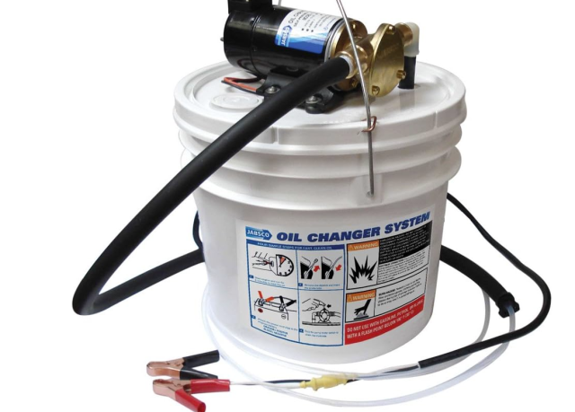

        I use Kirklands oil from Costco. It meets the spec. Used it in my ZR6 and my current ZZ6. As far as extractors I use the Jabsco one. I bought an adaptor that goes on the end of the pump hose and screws onto the end of the oil drain hose. It’s almost zero mess.

            When it comes to oil ideally, you'd want Pleasure Craft Marine oil - grade 10W-40. For sucking oil out, I'd recommend a jabsco oil pump sucker. You feed the line through the dipstick tube until it bottoms out, hook power/ground to battery and turn pump on and it sucks the oil right out, it is a bit slow but gets the job done. The best sucker though is an oem manual fluid extractor, you'd need to make the proper quick-disconnect fitting for this one though. It plugs right onto the oil drain hose that comes on all PCM motors and is the considerably the proper way to do the job.

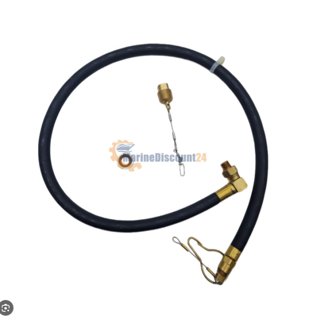

                I used to do the plastic tube down the dipstick tube for years until I nearly got it stuck. There are stories of this all over the forums which cured me of this method. Unless they've drastically changed how they equip the engines these days you should have a drain tube/hose that goes from your oil pan and is routed to the side of the engine. The hose will look like this....
                Click image for larger version  Name:	image.png Views:	0 Size:	132.7 KB ID:	684407
                That end with the metal clasp is typically attached to something on the drivers side of the engine. What I started doing some 15 years ago was attaching my suction pump to that fitting and draining the oil from there. To do this you'll need to go to the hardware store to get a brass fitting that matches what's on the end of the hose and make an adapter to whatever suction pump tube you have. I bought one of these when I first got into inboards some 30 years ago and still have it.
