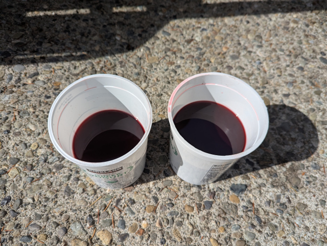

Doing some spring maintenance and flushed the trans fluid. Definitely shows some color change.
Here's what '80 hour' transmission fluid looks like

At first I thought those were five-gallon buckets, and I was wondering how in the world you had that much in there!!
Now I realized they must be smaller containers.Please do not PM me directly asking for advice on how to repair your boat. While I would love to help everyone, I simply do not have time to respond to all of the inquiries. Please post your questions on the forum, so that all of our members have a chance to answer.
Funny! Next time I'll add 'the banana for scale'.
They are 32oz yogurt containers each marked at a one quart line. I measure what I remove to help make sure the right amount goes back in. My hand extraction pump pulled out just under two quarts2004 206 Air Nautique Limited - Black with Vapor Blue (family style)
