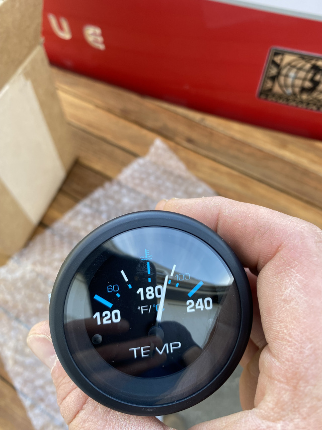

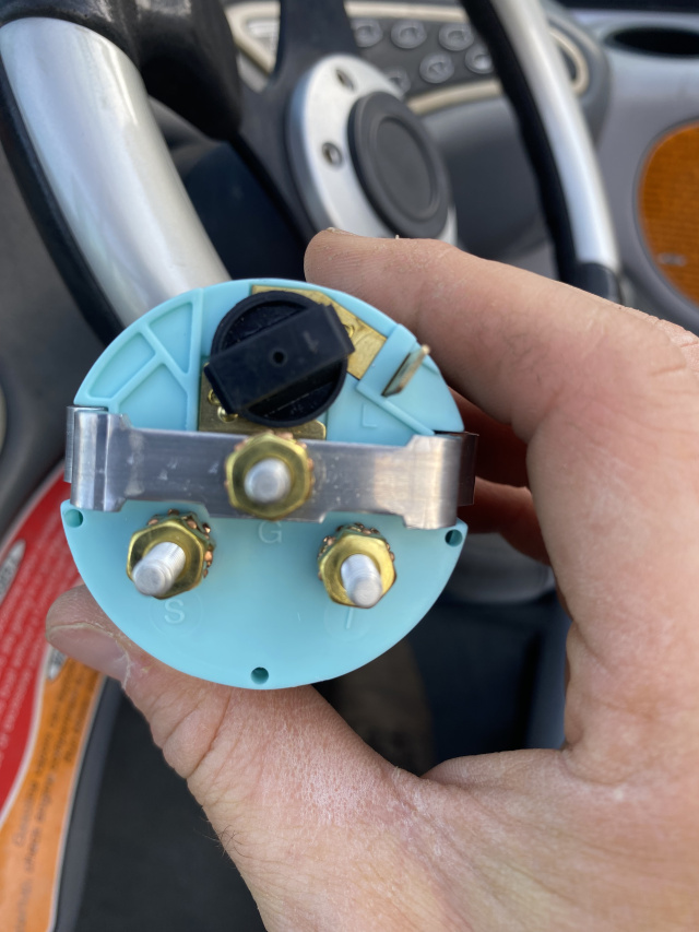

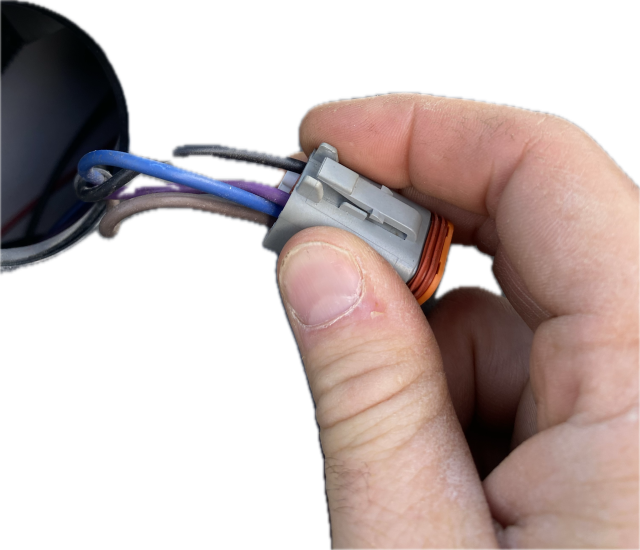

I just bought a 2002 Air Nautique and the first trip out the temperature gauge stopped working. I ordered a replacement but replacement has no way to plug the wiring harness into the back. The wire colors are the same as the wiring diagram, seems to easy to cut and attach to new gauge. Anyone had this issue or just cut the connector off and attached the wires to the new gauge? There’s a lot of talk about replacing the tac and Speedo but I can’t find much on the temp gauge. Also the new gauge came already reading a temperature is this normal or should it be reading zero?

Yep. I do this all the time. 2000 - 2002 boats have those connectors, and you have to cut them off and install ring terminals in order to mount the new gauges. The only one that doesn't get a ring terminal is the light connection. It takes a blade connector.
Here's a good blog post showing how we do this conversion:

Jeff, thanks so much for linking that and confirming you can cut off the connector and wire it up.
