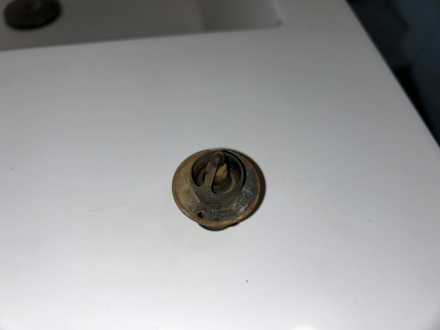

How do you change the exhaust cooling system thermostat on a PCM XR7 engine? My 2016 G23 has the one shown in the bottom of the diagram, below I removed the thermostat housing from the two hoses, and according to the engine manual the top and bottom halves unscrew. Looks simple enough, but I can’t g
Solved! I couldn't get the thermostat assembly apart because it was rusted from the inside. Penetrating oil, heat, a vice, and a plumber's wrench, and after giving it a talking to it finally broke free. The reason my G23 was overheating was because the thermostat to the exhaust cooling system was rusted shut, so no water was getting to the exhaust manifolds to cool it. This is a new-to-me boat, so it's a bit of a learning curve.
