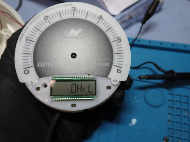

                    I can tell you from experience that the Faria gateway is a really complex box. Without schematics or direct support from Faria I doubt they really "repaired" it. Possibly replaced a bunch of electrolytic caps if it was truly "dead". I had another guy talk with me about the same exact symptoms (all gauges suddenly went dead). After a lot of remote debug turned out to be the cable/connector that runs from P3 on the gateway to the first Faria gauge, the dreaded Faria serial bus. I simply built him a new cable and boom, everything worked.
                    No doubt these guys know what they are doing, but before sending a gateway and 6 gauges to them I would do a LOT of debug. If the gauges just suddenly go dead but the engine/boat still runs I would suspect connectors first. Pull them off the gateway and re-seat them a few times. Clean off the pins, etc. If a gauge or 2 is out it's generally NOT the gateway but simply a gauge or 2 is bad. That's what the picture shows. I've repaired ~70 of them with pretty much 100% success. However, as folks will attest I pretty much mangle the back of the bezel that is not in view. If these guys have a machine that can remove/replace the bezel cleanly I'm interested in that part of it....

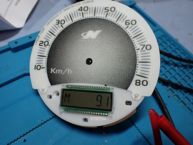

                        Hi ederaaff210, that is great news. I have a couple of gateways in my lab, one that is older pitot tube based and another that uses the paddlewheel input. They are very similar and are based on a large Microchip MCU. The pitot tube based one would be hard to recover if there was water ingress, which is the primary failure point. But in both cases there are several large electrolytic capacitors which likely also would fail over time. I suspect that they took the gateway apart, replaced these caps, and it came back to life. The hardest part in that procedure is getting the gateway open. I had a devil of a time with an older pitot tube based one. But your picture above shows a speedometer. I have repaired a bunch of those and have a YouTube showing the procedure for the smaller gauges. Not a big deal. At some point I'll produce another video on the larger gauges. But it sounds like they must have done "something" to the gateway as well.
