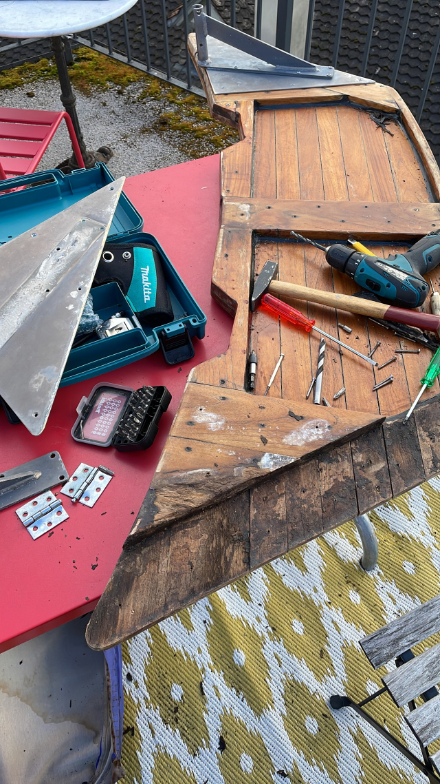

    I’m currently remodeling our wooden swim platform and was hoping for your inputs:
    - What kind of glue should I use to glue together the underlying stringer and the wooden top so that I will get an air and water tight composite. Looks like a black kind of silicone has been used by the previous owner.
    - Some wooden planks from the top layer look a bit rotten from the underside where the stringer was, is there some kind of treatment I should apply before putting it back together?
    - I didn’t want to sand it off too much as the whole platform should stay as strong as possible.
    Thanks for your inputs,
    Phil

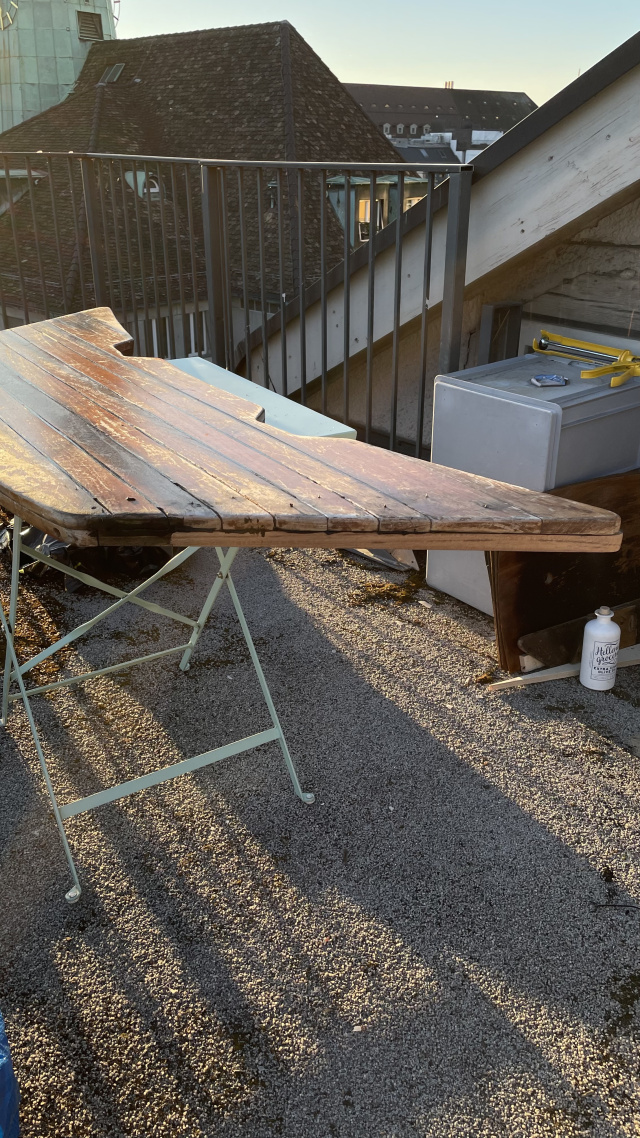

    I used this silicone:
    TDS Teak Decking System Deck-Caulk 305ml
    and it worked fine.
    using stainless steel screws should also make it more durable.
    end result:

      Sorry to see no oner responded to this as that is not typical.
      Looks like you've already committed to a resolution but I'll throw in my thoughts and experience.....
      I've never glued anything when it came to the platform. MY understanding and experience with the MasterCraft Platforms at least, was that everything was screwed together and that was it. I had to replace a couple boards on a 97 ProStar once and I basically unscrewed it from the bottom and lifted the board away. Got a new one from Teak World
      https://teakworldenterprises.com/col...swim-platforms
      which I was told makes most (if not all) of the platforms for the tow boat manufactures. As a side note.... they ain't cheap. Don't know how much it was but I do recall I was shocked by the price.
