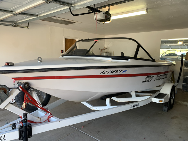

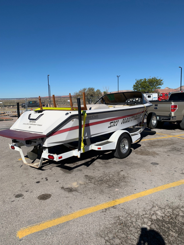

      Good idea on the spark plug wires, Didn't do that. It has an electronic ignition so no points or rotor needs replacement. Not sure that any electronics will compensate for the low compression, high cylinder leakage I'm seeing but it wouldn't hurt.
      Added a couple of pictures for fun to show general condition. The trailering picture was off I40 in New Mexico I believe.
