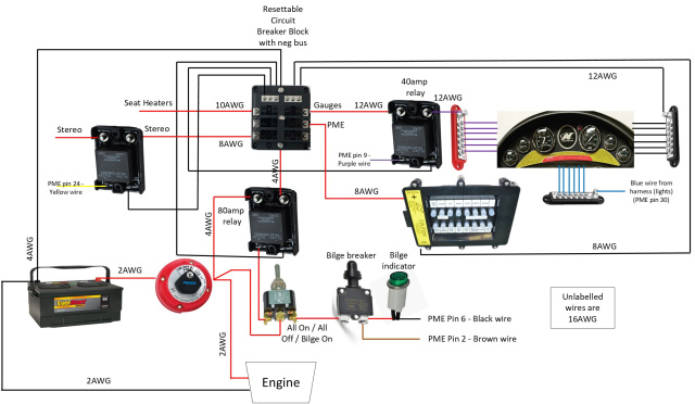

    After reading up on all the power and ground wiring challenges, I have been working on a diagram to rewire my new to me 2000 SN. I would greatly appreciate any feedback on it though. Here it is:

    That looks pretty well laid out. I don't really have any comments. I know there are some others that have bypassed their keypads on the site in case they stop working.
