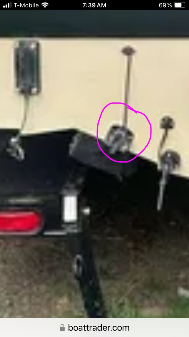

            Here is a pic of the paddlewheel on the stern of a 2004ish 226, not sure if this was a typical V-Drive configuration or a 226 only thing

                  Does seem odd - Nautique Parts has this transom mount labeled for a 2006-2008 226?

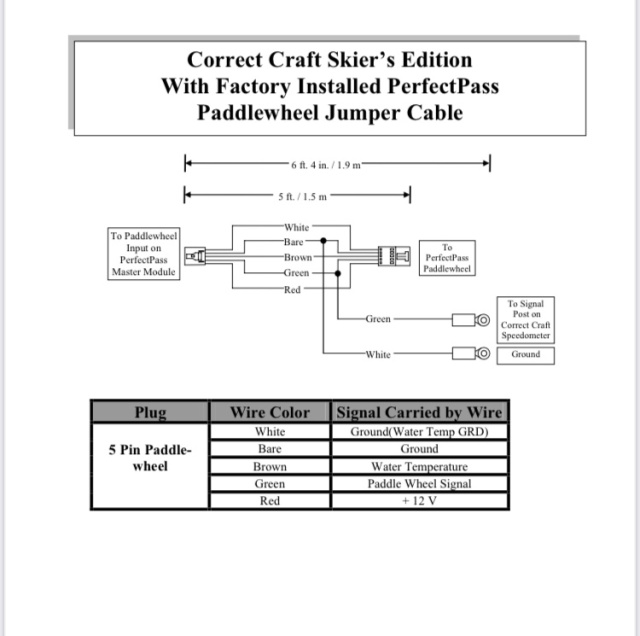

                      Looking through the 2003-2005 Brochures, it shows the SEs all having “Analog Faria Gauges” with Perfect Pass as an option. Here is the speedometer wiring diagram from Perfect Pass for the SE’s equipped with PP in that time period- no Gateway to deal with.

                          That sounds like a good summary - the 2003 thru 2005 Brochures seem to suggest PP was an option for SE/LEs (standard on Team’s) so if someone has the pitot Gateway and no paddlewheel, the transom mount Airmar paddlewheel (ST69-HS) listed on NP should provide approximately the same speed signal as that from the factory installed Airmar thru-hull product. Checking with Airmar Tech support, this particular transom mount was designed specifically for Faria.
                          Mark at Perfect Pass is working up a quote for the jumper to bring the wiring back to the Gateway from the thru hull paddlewheel, I will post that here once i have it.

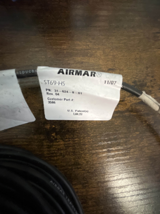

                            Just a quick update, Mark at Perfect Pass has shipped the paddlewheel jumper cable ($45 USD + shipping) - he designed it to split about 7” prior to the PP Master Module connection and gave us 23’ of wire (Paddlewheel Signal, Ground, Power) to make the run to the Gateway. Way more wire than we need and likely will not need the Power (Red) wire but wanted to make sure we didn’t run short and will refine from there. Sounds like TechBeer is getting close with the circuit design.

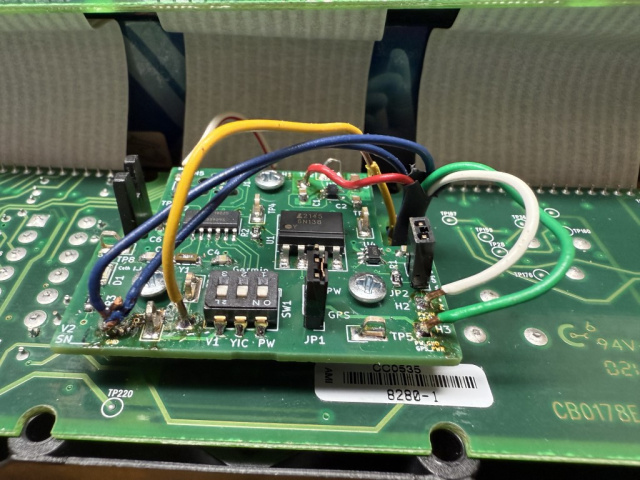

                              Another update for those following this thread. I have developed a small circuit board that fits inside the gateway (pre-2006 with the pitot tubes). Picture below. Using this board you can plug up the pitot tube holes in the gateway and your speedometer will still work (!). There are 3 options (same board): 1. Use the paddlewheel that is present on most boats connected to the Perfect Pass with the jumper cable described above. 2. use a stand along GPS puck (that I can provide), or 3. use the PP Garmin puck used when you upgrade to the Stargazer along with a jumper cable. I have tested all 3 modes on my lab bench and the GPS option in the car. I have not yet been able to test in a boat because mine is a 2006 model without the pitot tubes. The basic theory of operation is the pitot pressure transducer is removed from the gateway and I am driving that signal from this circuit board. The signals are brought in through an unused connector on the gateway. The picture has a few extra jumpers for testing so the final version would be "cleaner".
                              I would like to test this concept on the water so I'm looking for a volunteer that lives in the metro Atlanta area that might be interested. Again, the boat has have a pitot tube based gateway (~2003 - 2005 ish) and maybe you have already plugged the pitot holes or would like to. Once I have fully tested it I would open it up to others that are interested.

                                Whoa. This is seriously cool. Not even close to ATL but will still put my hand up as a possible tester. I have a pitot gateway boat, factory paddlewheel and a stargazer PP setup. And...a spare gateway box in case things go totally sideways.
