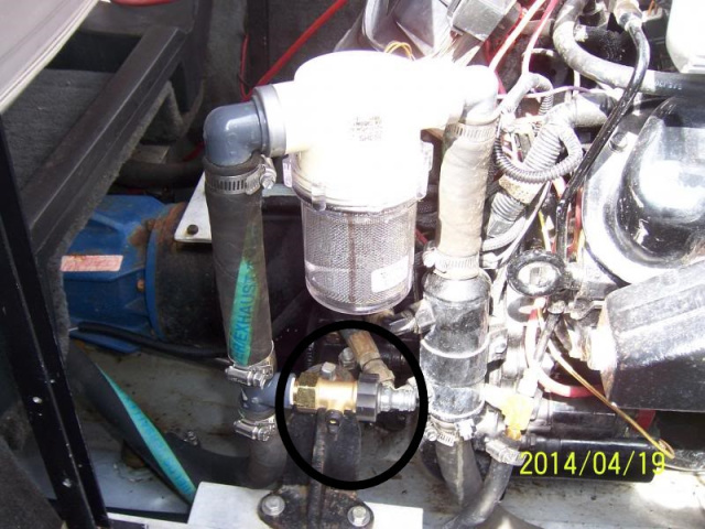

Fake a lakes are notorious for not working. This is what you need- the hardest part is finding the T to fit the size of your hose you connect to that's before your raw water pump. some Ace Hardware's have them especially ones that have irrigation supplies, Home Depot has the other 2 parts. Here it is mounted in my Super Sport just before the strainer. I also have a quick snap on fitting in this picture which is up to you to use. You connect the hose, turn on the valve and start the engine- excess water will come out the intake port of the boat but that's ok. When done you turn off the valve and disconnect the hose - nothing could be easier. It's been nicknamed the Timmy T and was on Correct Craft Fan if you do a search
Amazon sells the TEE fitting. Search for 1" X 1" X 3/4" FPT tee barb: Link
Then you add an adapter for the 3/4" FPT to garden hose. You can also purchase a Plug or Cap to securely close off the garden hose adapter when the hose is not connected up.

Ok. I found all the parts and installed this week. The hose dumped all of the water out of the bottom of the boat and the engine didn’t really suck any water through until I stuffed a rag in the fake a lake and shoved it under the boat to create back pressure. Is there supposed to be another valve below to partially shut?
