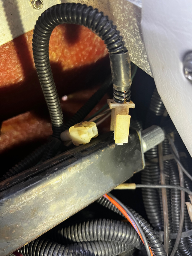

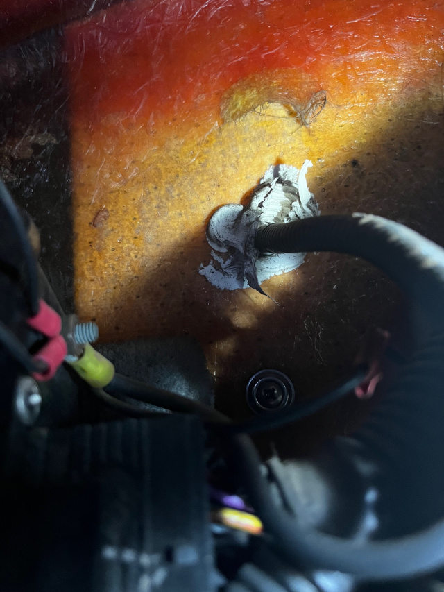

    In case this happens to anyone else, what I found was that the cause is the ignition keypad, which is where the horn button is located. Using suggestion from Woody at Nautique Parts, I disconnected the keypad and the intermittent honking went away. Note that the horn would honk intermittently on its own whether the ignition was ON or OFF. As a temporary solution, I disconnected the horns. I found a thread on this site showing where the horn hot wire goes through the fiberglass wall under the dash and above the kick panel. Mine was different from the picture and confused me at first. I was looking for an orange wire, but what I have is a black wire loom with an orange wire with a bule stripe and a black (ground) wire. I also was lucky that I have a wire connector on those two wires and all I had was to unplug the connector to kill the horns.
    I ordered a new key pad but it is black instead of wood grain. So I will likely just save the key pad for another day when it is needed. I live on a private lake so I am not worried about not having a horn.
    While doing this search, I also saw a thread showing how to program the keypad. I programmed a simple 2 digit code using a button that was not in my original code. In that thread, I saw two people who said they did not use any code, but I did not see any one respond to the question of how to do that. Anyone know? Click image for larger version
