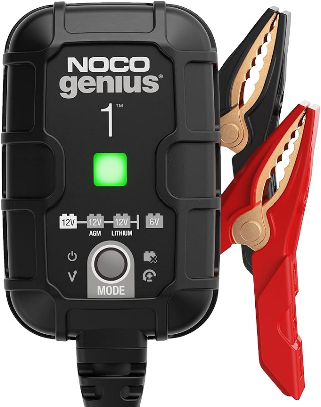

    Multiple ways to skin a cat, but I went to the NOCO system a while back. Mostly for convenience with too many batteries to keep track of between toys and equipment. I've hard wired everything so I just plug the units in to the harness on each rig. I bought a stack of them and just do a multiple on going rotation between rigs, it sounds like a process but it's just an easy routine. They have a decent line up to choose from to meet your preference. Not affiliated, just needed something that worked for me. Of coarse the boat has it's own on-board system, so no worries there, just have to remember to plug it in.
