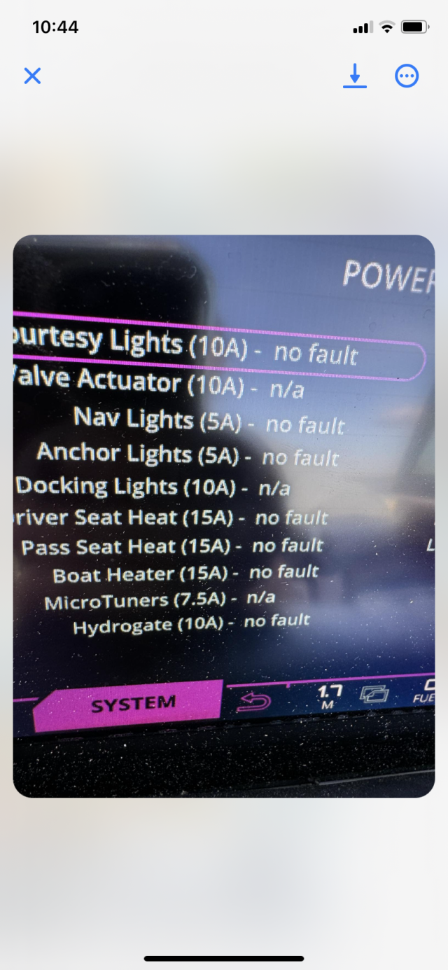

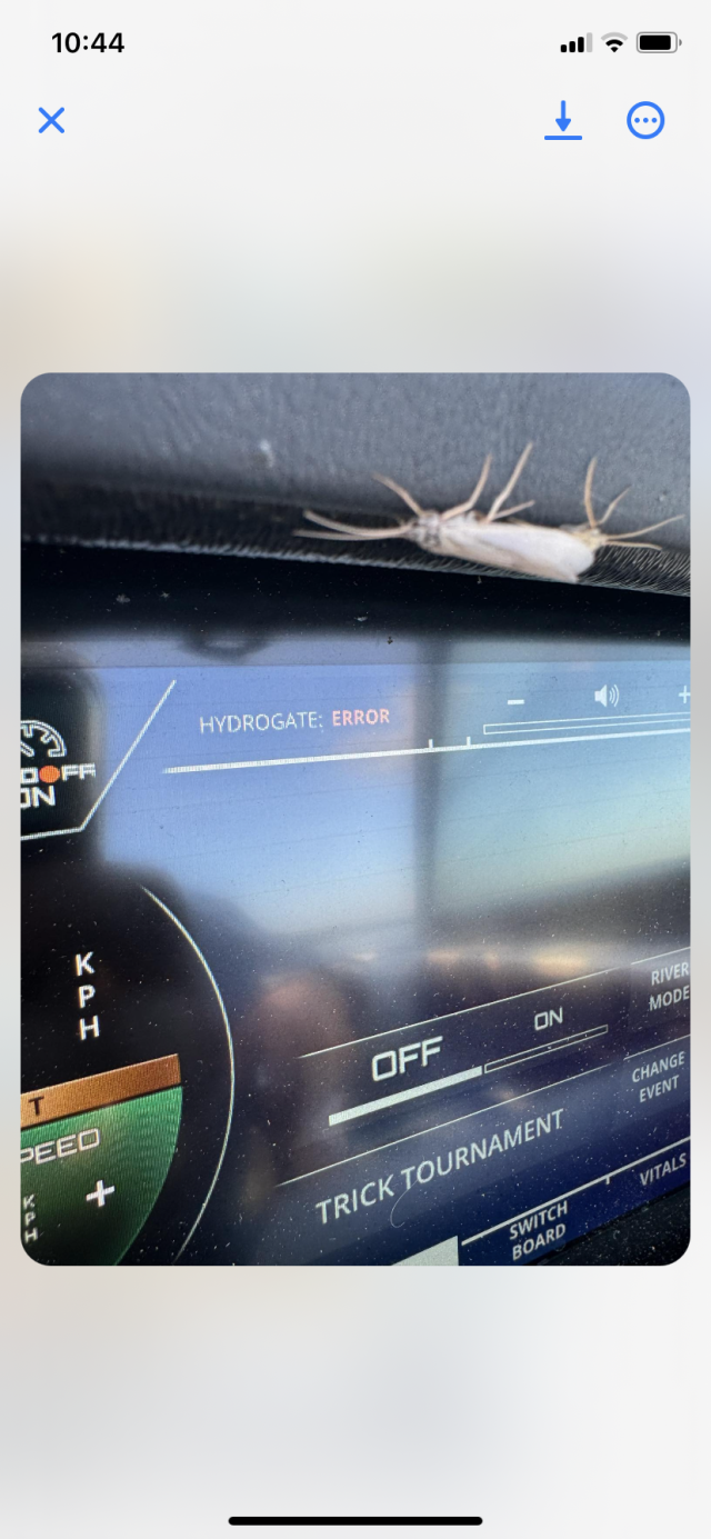

    We have an error in the display on our 2019 SN 200, saying "Hydrogate error". We just replaced the actuator/motor, but still have the same issue. As far as we can understand the gate moves fine and the wire/cable works fine. We dont really have a clue how to continue troubleshooting, maybe someone have experienced the same thing?
    Attaching display photos, appreciate any advice!

    The picture in the first screen shows the state of the power distribution module in real time. Meaning that you have to be looking at that screen when the error occurs, or the error has to be continuous. Most PDM errors auto-clear almost immediately if the error condition is transient. Also, the hydrogate and micro-tuner actuators are connected to the CanBus and are controlled by digital messages. So, I think the entry in the PDM screen diagnostics you're looking at is only the power feed for the actuator. The actuator itself can generate its own error messages via the CanBus.
    I would diagnosis this by attaching a CanBus monitor to the boat, but short of that, I'm not sure how to tell you to proceed other than to take it to a dealer.

      According to the 2nd pic, it's pretty obvious you have a bug in your system (sorry, couldn't help it)
