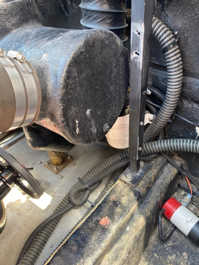

    So the keyboard switch light will turn on, no blower, then trips the breaker when pressing on and off. I am guessing the blower motor is bad, but where is it? I have checked other posts and cannot find the info for my boat.

    I found it...port side back against the transom.

        Hi JDC02SANTE, I replaced my hard tanks with plug and play ballast bags some time ago, so it was pretty easy. I read other posts that say if you have a hard tank, it's best to remove it to save yourself the grief.
