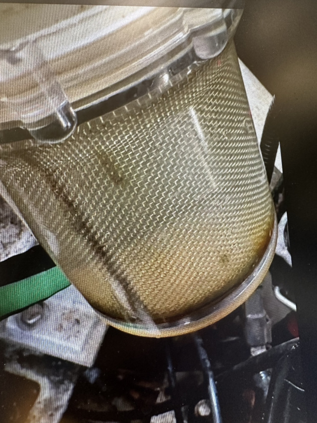

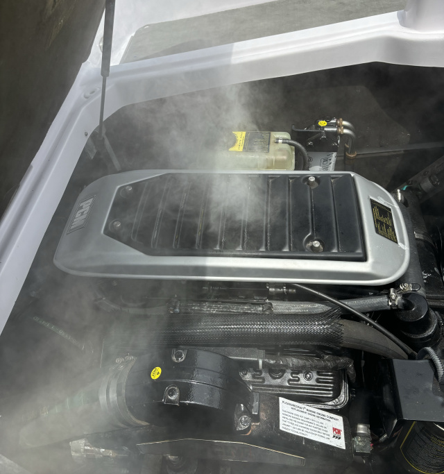

    I have a 2010 Nautique with a 2014 PMC Excaliber engine. I launched the boat and notice the temperature climbing as a motored to our slip. Over a 5 minute time period, the temperature rose to 175 and then to 250. I barely made it to the slip. There was smoke coming from the engine (photo). I have a marine heat exchanger system. All the values were in the proper position and my dealer just replaced the impeller. When I was doing the trouble shooting, I noticed there was no water flowing through the transparent filter (se photo). One person thought my water pump was not working. It is very difficult to find mechanics at my location in CT so I am asking for advice to fix this issue. Incidentally, there was no engine damage. The engine started right away and sounded normal. I really appreciate your help.. Thank you.

    start from the pick up off the bottom of the boat and verify everything yourself. If you unscrew the filter housing on the strainer there’s no water in there?

      Inspect the color of the oil. Go ahead and get some head gaskets. If the impellor is shredded, look for parts around thermostat housing and each side of the exhaust where the water enters.

          • Pull the strainer off, clear any debris wash out cup, inspect O ring, lubricate with plumber's gears (silicone grease), reinstall and check cup is sealing properly.
