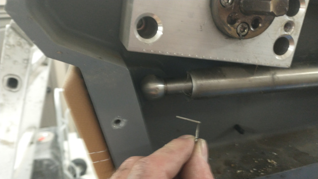

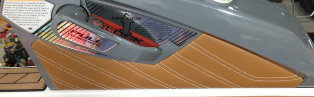

          The bummer is the stickers will need to come off to gain access, you may be able to get them off alive with a heat gun & patience, don't count on it. The panel are just pry Christmas tree studs.
          I believe those gas shocks are spendy buggers, maybe yours just need a little adjustment. Even with the assist of the shocks those towers loaded with the speakers and the bimini are awkward heavy. I've got it down to a science, but I still have to go into 3 big breaths power lifting mode. 2 people can handle it, with or without shocks.
          Good luck, chart the process if you go that direction.
          You can compare the pictures above somewhat with screw access.
          • Scooter G
            • Jan 2022
            • 1509
            • On a Lake in Idaho
            • 2022 G23 ZZ8
            Umm, scratch that last thought, you can access the screw without removing stickers, I found a picture. The panel and handle will still need to be removed.

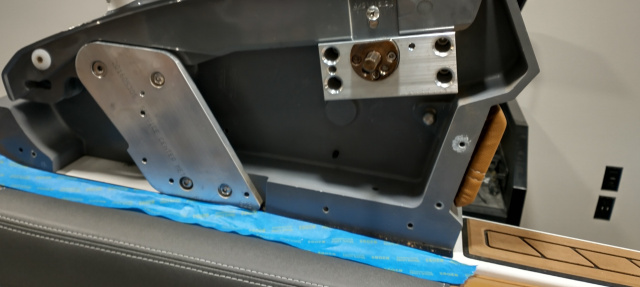

                Pictures got eaten on a site crash. Here's what I found in the archives, hope it helps a little.
                • Arvster
                  • Oct 2025
                  • 3
                  • Kelowna BC
                  • G25
                  Thanks for the pictures.

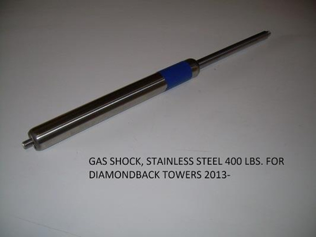

ID:	688254Just to be certain. These are the shocks on Nautique Parts site
                    • Scooter G
                      • Jan 2022
                      • 1509
                      • 2022 G23 ZZ8
                      Looks like the correct ones, and the only tower struts listed for a G on Nautique Parts. You can re-use your current shock ends. I would call or email NP just to be certain.
                      $267+, ouch. Are you out of warranty?
                      Use the code PND for 10% off, that will get you covered for taxes and shipping.
