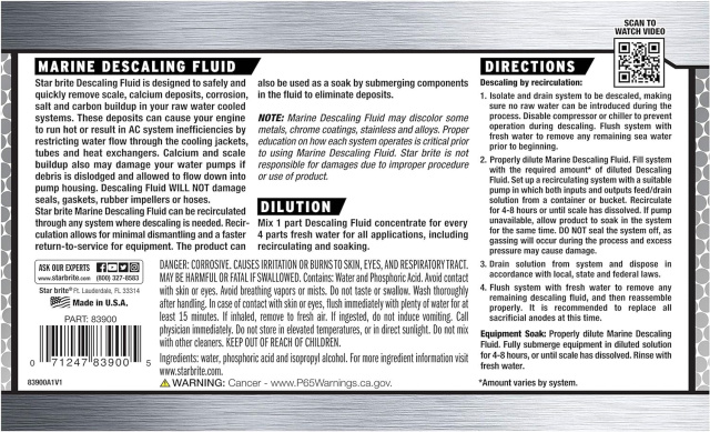

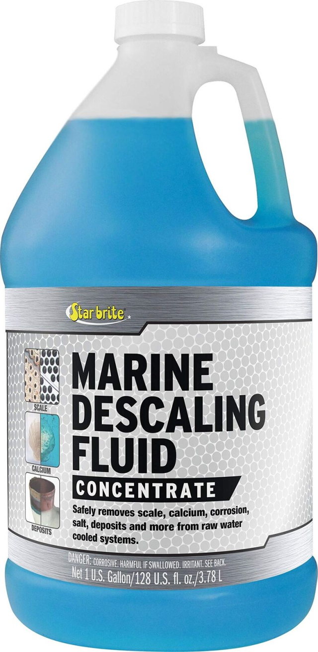

    Has anyone tried an engine flush with the engine descaling fluid on the "Modern" wake boats with heat exchangers? May be a waste of time but I was thinking of giving it a try.
