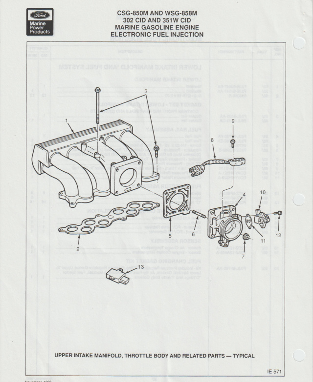

                    Probably not many left here that have the older Ford powered boats, but Ford had produced parts manuals for what they supplied to PCM- it included all their oem part numbers. Here is just an example of 2 pages I happen to have on me. I do have the complete book if someone needs it just don't have it with me

                    Click image for larger version  Name:	FORD MARINE.jpg Views:	0 Size:	261.5 KB ID:	675822
