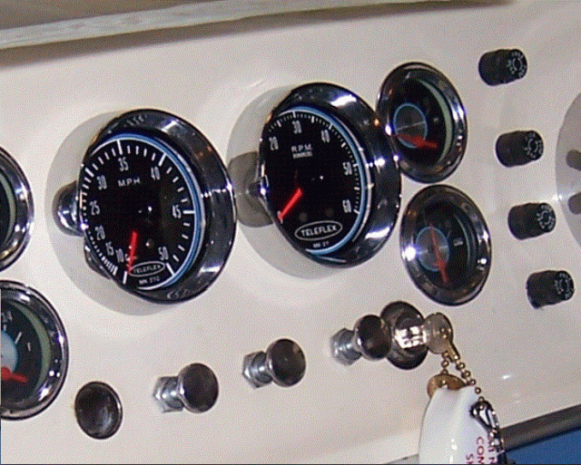

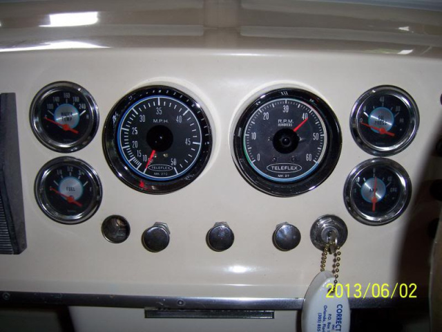

    A number of years ago a couple of us on Correct Craft Fan had our Teleflex tachs re done. What he had to do was remove the original insides and convert it over to Autometer insides. I do think that since then the business was sold. Anyway it took well over a year for the both of us, was not cheap and was disappointed that he did not redo the face, you can see it's faded. It worked fine but was not about to send it back in to do the face since it had taken so long. After it was all said and done about another year later I found a NOS one for under 100 dollars and put that one in. The first picture is the tach that was redone, the second one is the NOS. Dale Kocian was the owner/restorer see if he's still there and see what the turn around time is- he always said he'd get it done in a month- about after 6-7 months the two of us would switch off calling him every month
