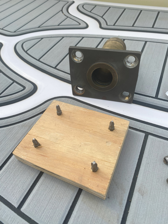

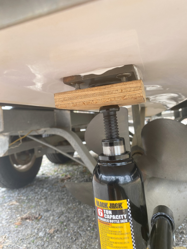

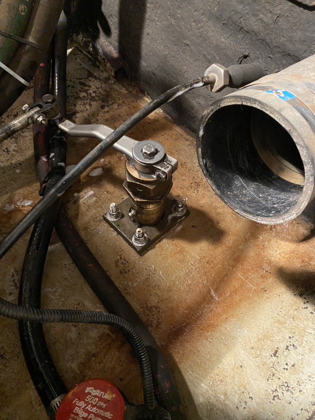

        I want to share the jig I made to allow me to re-install the rudder port without an assistant. Just a small square of 3/4" ply wood with for holes drilled to hold Phillips head drivers (drilled undersized and tapped in with a hammer). Placed the screws thru, loaded it up with 3M 5200, lightly seated it in place with a jack, and then went inside to place and low-torque tightened the nuts. Let it sit for 48 hours and snugged it all up.
