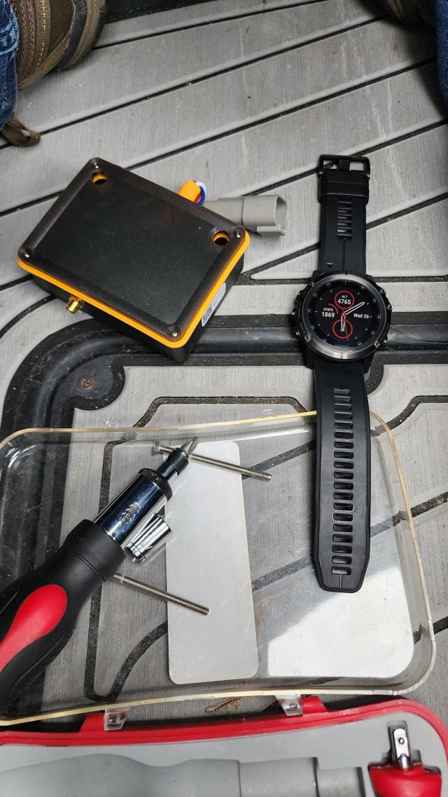

          So I solved the problem tonight...
          That's a 3.0 module the dealer had in stock and a Garmin Fenix 5x Plus that was for sale nearby on Craigslist. I swapped out the module and the watch paired right up when I turned the boat on. A quick test showed everything working again. And the watch has the correct time. :-)
          Now I have the world's largest collection of useless Pebble watches and Surf Select 1.x and 2.0 modules. Maybe they'll go up in value like baseball cards.
