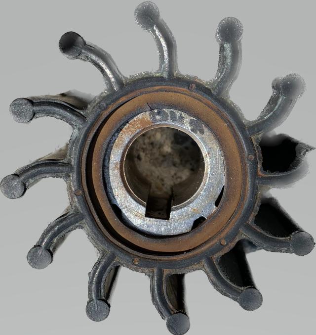

    5. Changed impeller and temp back at 160F. Old impeller looks like the rubber vanes may have been spinning independently of the core (metal center with the key slot). Looks like rubber vanes have shifted relative to this metal core, see pic and bulge around core. Is this odd? I thought vanes would be destroyed for an overheat. Impeller was 1 year old and marked with Sherwood on rubber (thought Sherwood has a brass core though). Hope this is not another failure mode to worry about lol.

        That impeller failure you found (where the hub separates from the rubber) is unfortunately somewhat common on different runs of impellers. I've had it happen as well (the one time I didn't put a new impeller in for the spring). The only good part about that type of failure is you don't have to chase down any rubber pieces like you do when they lose the fins.
        Regarding the smoke, hard to say, but it's not a bad idea to check your exhaust hoses, as they can be damaged on an overheat. I'd recommend pulling an end off to get a look inside the hoses to make sure the interior lining hasn't blistered up or melted. It's also possible the smoke is some latent oil grease that cooked off on an engine that was a bit hotter than it usually is....
