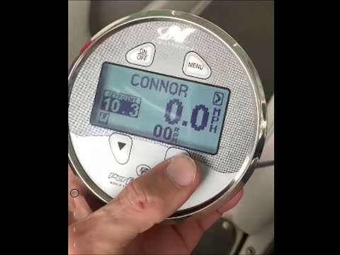

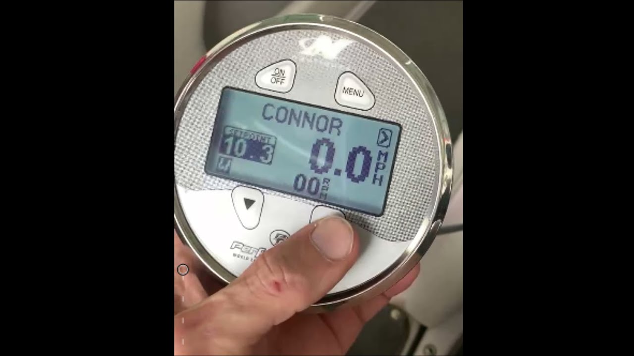

    Try this even though your buttons work. My screen was on the fritz too. Also while you have it open, stick some of those moisture packets in there that come in vitamin bottles.

      I sense a StarGazer upgrade in your future. While the price is a deterrant, it's a simple DIY upgrade.
      I personally think silica gel packets are not a great idea. Sure, they absorb moisture, but they have a finite amount they can absorb, and they you've got a saturated silca gel packet inside your display.

        I agree that the silica packets are just a stopgap. But I did it to mine 3 to 4 seasons ago and have not had the display issues since. I was just trying to avoid the cost of the upgrade, hoping I might find a new display for sale along the way, but the problem never returned.
