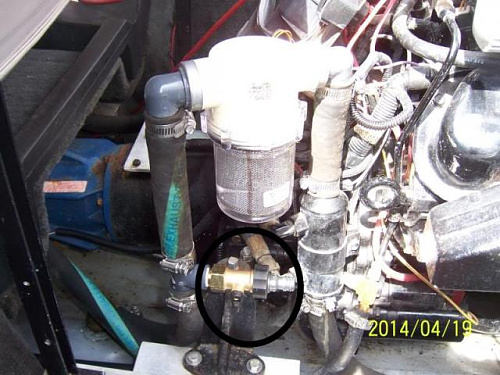

      You need to look up Timmy T on CCF. The perko one has been known to fail.

          That's the beauty of the TimmyT any excess water pressure goes out the boats thru hull. The raw water pump will pull whats needed to cool the engine.I added a garden hose quick connect as you can see in my top picture. Second picture shows the parts you need,hardest part to find is the plastic 1" T, the other 2 parts can be found at Home Depot. They have been used for a lot of years on the the CCF site. I have one on every inboard I have.
