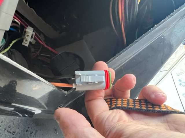

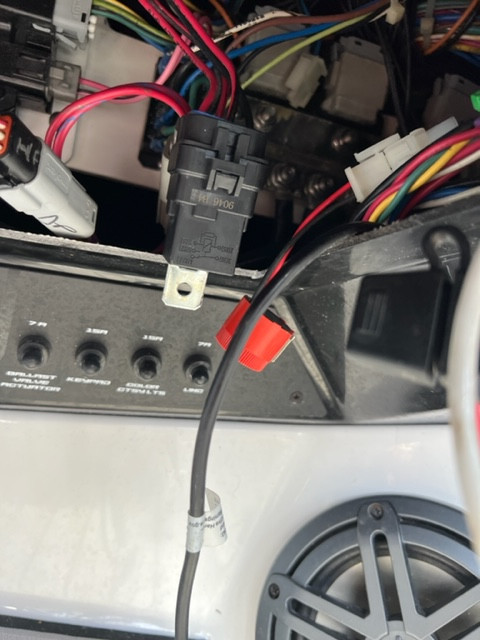

    As an update, I think I may have resolved the issue (hopefully). I tested the battery voltage (13v) and then disconnected the terminals. While disconnected, I thoroughly cleaned all of the terminal and ground connections and binding posts with electrical cleaner and checked for corrosion (none). Pulled the dash panel and found several of the wires and subharnesses loose.

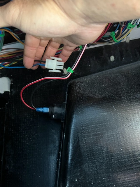

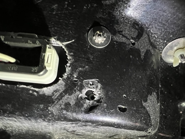

    The Linc head unit had a missing screw that was floating on the floor that I reinstalled (doubt that this caused the problem, but now its fixed). I pulled all the spade connectors and cleaned w/ electrical cleaner and press-fitted the remaining plugs and took pictures of the loose ones. Found a total of 2 USB B's that were unconnected (I assume they are for service and not related to Linc).

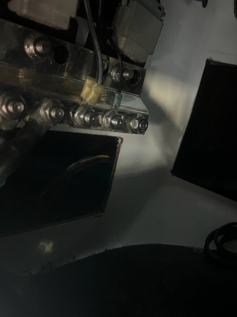

    Found one nut loose on the right most screw of the binding post, but the screw is too big for the large wiring connector w/mounting plate that is loose. Found and took pics of the remaining open connectors.

    Still don't have a solid reason why there was an issue since all of the pertinent connections seemed connected. See pics attached of potential issues...let me know if you have any idea where these connectors are supposed to go, if they are supposed to be attached at all.
