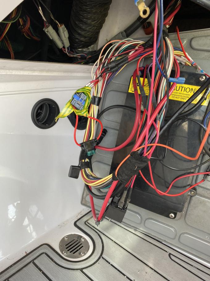

                I had exactly the same problem on my boat a few weeks ago, 08 210. It was the relay that feeds the dash that went out. Really poor design in my opinion, heavy gauge cable to just before the relay, dropped to light gauge in and out the relay, then back to heavy gauge to feed the dash. I swapped out for a 100a relay, retained the same gauge of cable throughout and problem-solved.
                took a while to find the problem, checked the toggle switch and kill cord before noticing the relay was warm, metered it and no power to the dash.. to access, drop the kickplate
                panel to access the wiring under the dash, and follow the 8awg wiring from the main breakers under the dash back to the relay.
                based on your description with the symptoms being identical to mine, i would recommend replacing the relay, it’s just a 40A, no need for anything special. If you have any doubts, remove the relay and put a jumper across the two high power contacts, ie not the ones from the master toggle switch or earth. This is what I had to do when the relay failed whilst we were on the water.

                      Your answer lies in my post above. I had exactly the same scenario as you, dash went out, then was intermittent for a period ( a year actually), then died completely. The relay under the dash was the culprit, and most probably the culprit in your case..
                      If you don't want to modify (and improve) the wiring, and I understand a lot of people aren't keen to carve into the wiring on the boat, then replace the relay, its cheap and available on eBay, at the very minimum, you're removing one fail mode. relay pictured below.
                      Corrosion on the contacts for the relay can contribute to the problem, potentially the relay in not energising due to the increased resistance. Look carefully at the contacts, any corrosion needs to be addressed (this is also a reason as to why I cut the loom back as the female socket the relay plugged into, despite being sealed, was showing signs of corrosion).
                      Good luck and pls let us know how you get on.

                        It always amazes me on how poorly some of these Top Level boats are wired. My 07 MC was pretty clean, but not without several coils of plastic cladded wiring here and there. The couple of Malibu's I've worked on were a mess under the dash. Pretty much like ally's picture along with area where the wires were not properly supported. From what I've seen on my 16 Nautique, I' fairly happy. The breaker panel is neat and the wiring going to the dash seems to be clean as well. Stereo areas on nearly every boat I've worked on seems to be a weak area. I've yet to see one that didn't have a ball of cable hidden out of the way somewhere.
                        To be truthful none of these wake or ski boats can compare IMO to the Cobalt I owned or the couple of Formula's that I've worked on. Those brands had it dialed in or at least the boats I worked on did. Everything was labeled, well routed and supported. A relay like the one above would have been mounted to a bracket and labeled not taped to a cluster of wires. Don't know if that inline fuse was added by someone but that type of thing is completely unacceptable in my book.
                        • ally505
                          • Feb 2012
                          • 180
                          • Somewhere cold and wet
                          • 2008 super air nautique 210, zr6.
                          Ha! Well spotted!! The inline fuse was the cable I had onboard the boat that I was using to bypass the relay and limp home. The insulation tape was to hold the wire in place.... But I agree, the wiring was okay, not great under the dash. the relay was not supported properly as it should of been. Varying gauge of cable is just silly, 3 ballast pumps running, blower, heater, lighting etc must have got pretty close to 40A, the max capacity of the relay. All wiring was however labelled, but with a 14 year old boat some of the labelling was pretty difficult to make out.
