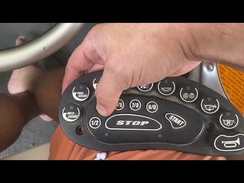

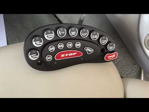

Guys, I’m having trouble with my Nautique and believe it to be PME and/or keypad related. With the original PME and keypad when I turn the 3-way switch to “All on” some or all of the lights come on randomly and there is no response from entering codes or any ability to turn on accessories like the blower, bilge, etc. Given this issue, I ordered a new PME and keypad and installed them today. With the new PME and keypad installed, the second I switch the 3-way to “All on” the starter motor starts cranking. This is without pressing any buttons on the keypad. Pressing stop or any other buttons has no effect. No indicator light illuminate on the keypad at all.
Part numbers on the PMEs are identical. I have videos of both the old and new showing the different symptoms, but can’t get them to upload to the site. I’ll try to get them on YouTube and linked. The starter was 1 season old and I swapped it to a new Nautique starter to confirm it wasn’t anything to do with the starter. Both starters begin turning the second power is applied as show in the videos. Any guidance or ideas on this?
