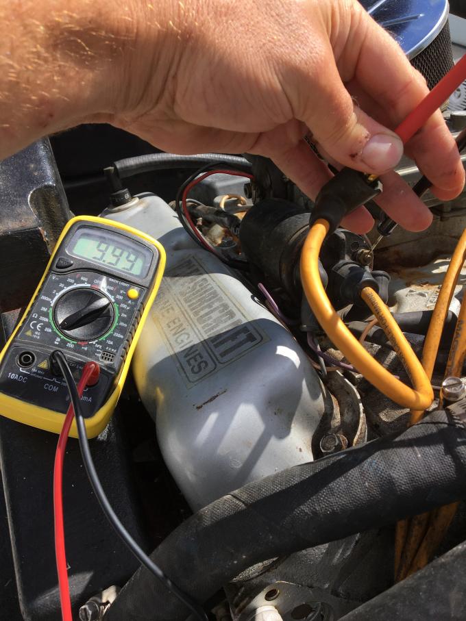

        if your getting 9 volts at the coil your ballast resistor is good.
        The last coil I got for my ‘85 was a Standard 1.5 ohm UF-2 and it should say on the box “external resistor required”

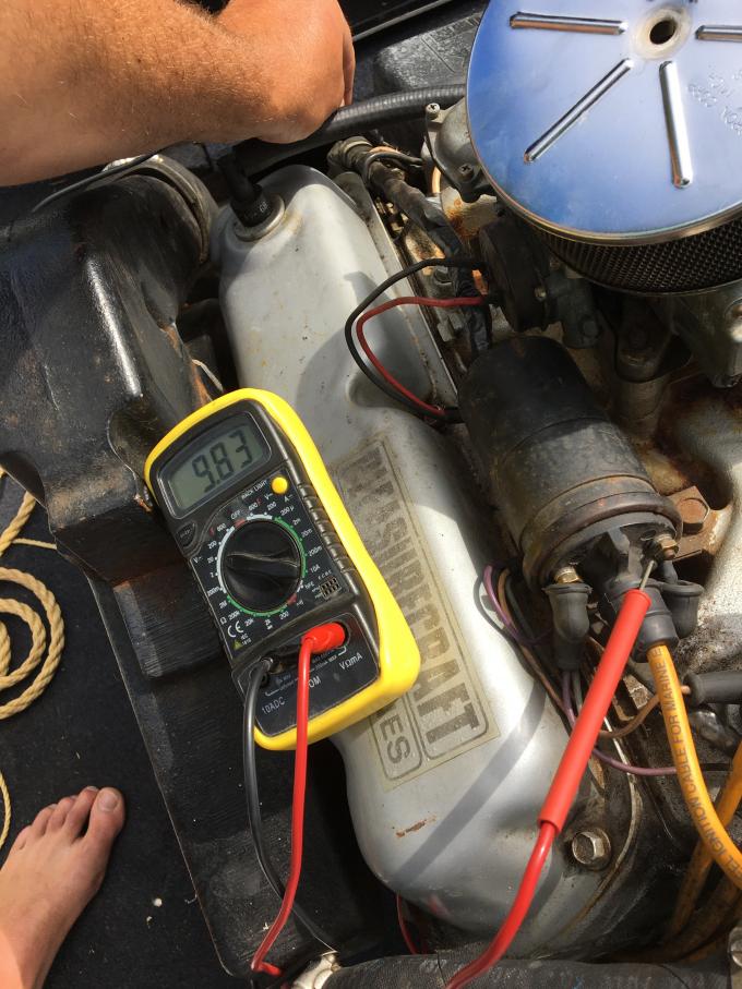

          Just measured 9-10 volts at +_- coil terminals with ignition on.
          • GoCanada72
            • Aug 2021
            • 27
            • Canada
            • 85 Ski Supreme
            Here is a pic showing voltage

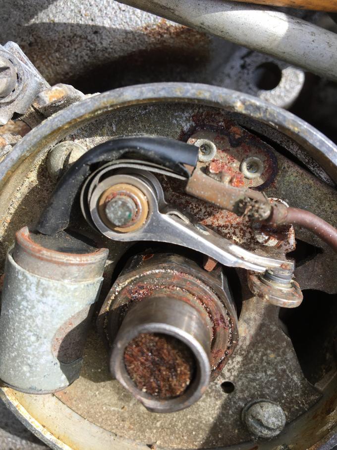

                  Your points fire the spark from the coil. Could be wrong, but the old coil looks good. Maybe something under the cap, a bad condenser, usually under the cap, will shut you down. Points look good?
                  Check to see that your rotor is actually turning when you crank with the cap off.

                    To test the primary resistance you need to disconnect the + and - wires the check across the to studs.

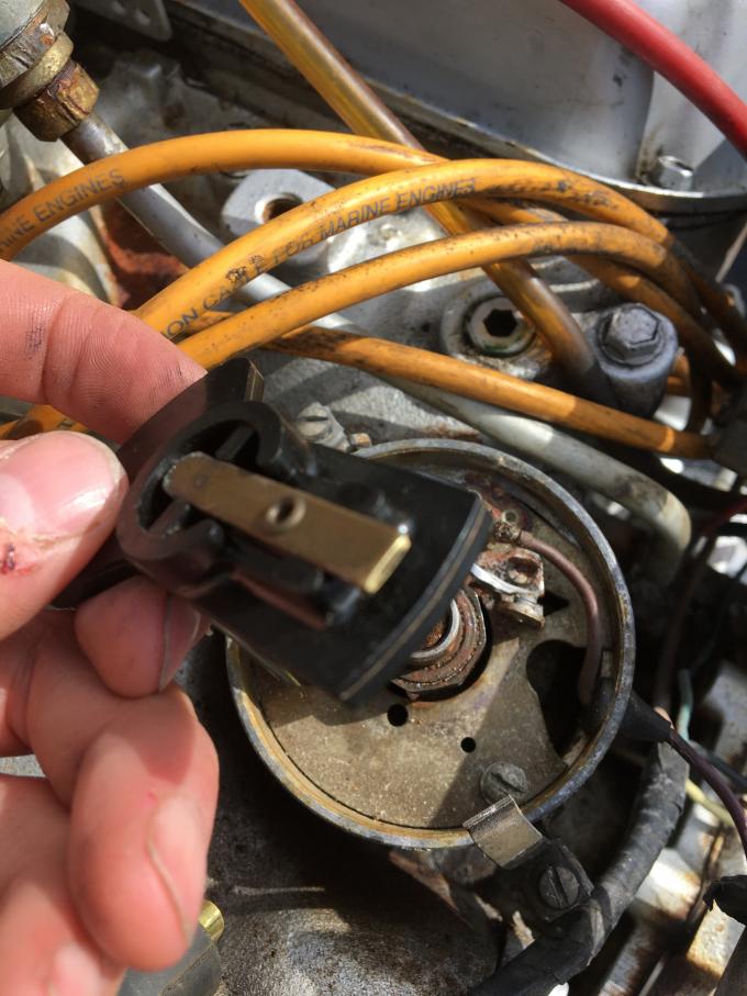

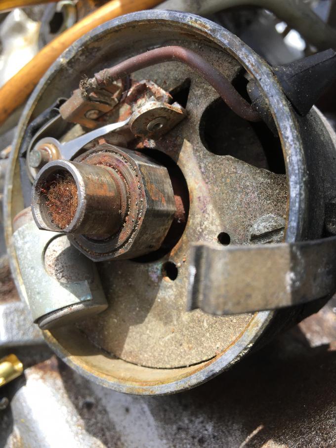

                          Inside distributor
                          • GoCanada72
                            • Aug 2021
                            • 27
                            • Canada
                            • 85 Ski Supreme
                            More of same

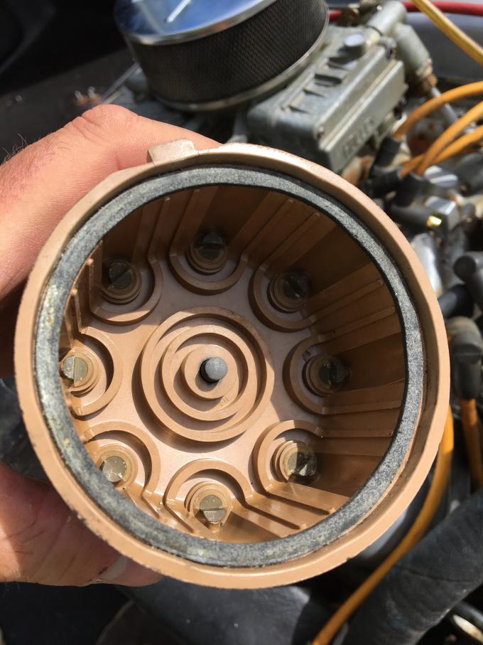

                              • 85 Ski Supreme
                              Inside of cap
