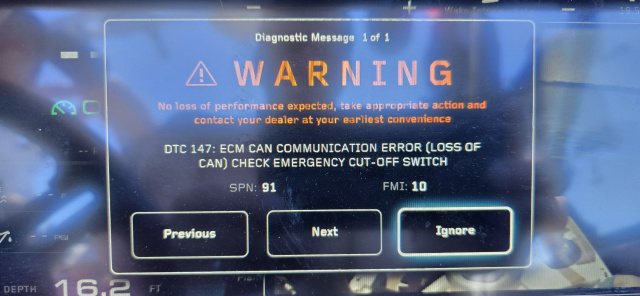

    Just got this error code on 2022 Super Air Nautique G23:
    DTC 147: ECM CAN COMMUNICATION ERROR. (LOSS OF CAN) CHECK EMERGENCY CUT-OFF SWITCH.
    Anyone have any experience with this?

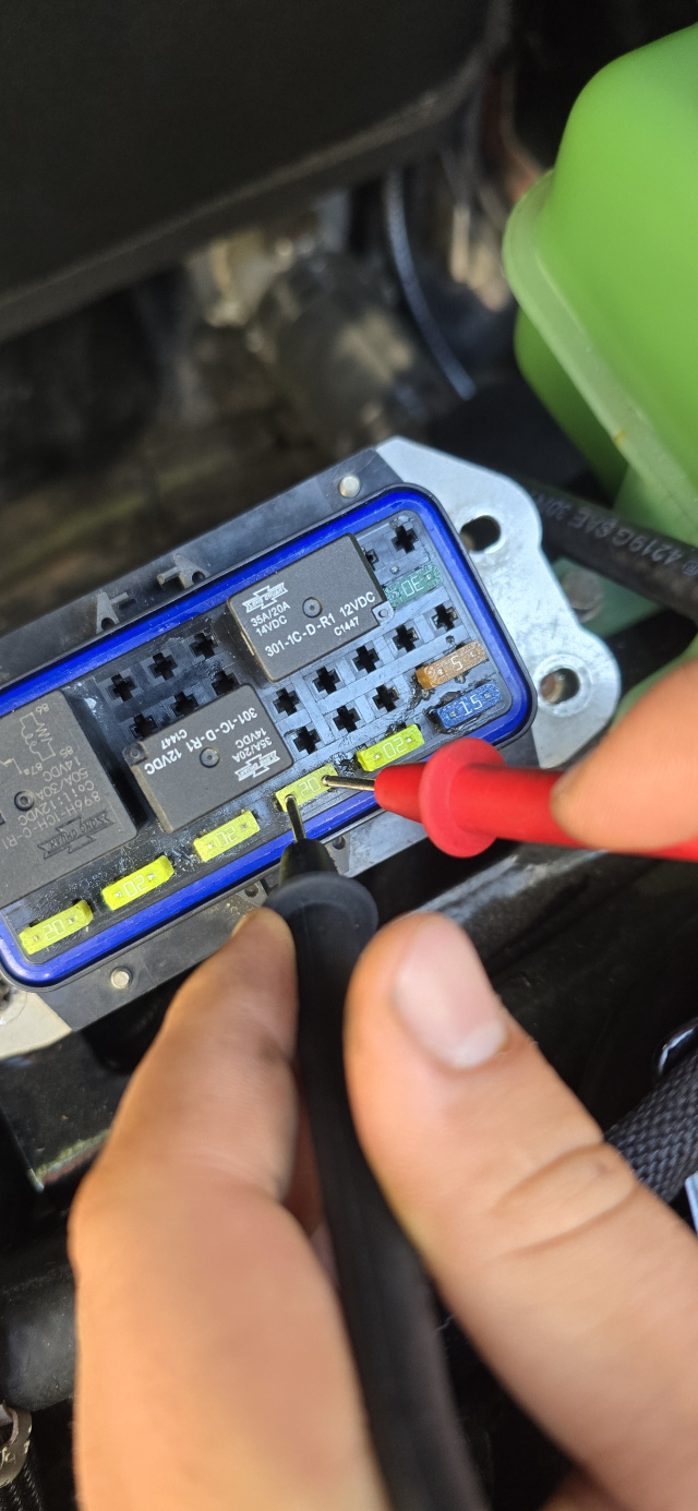

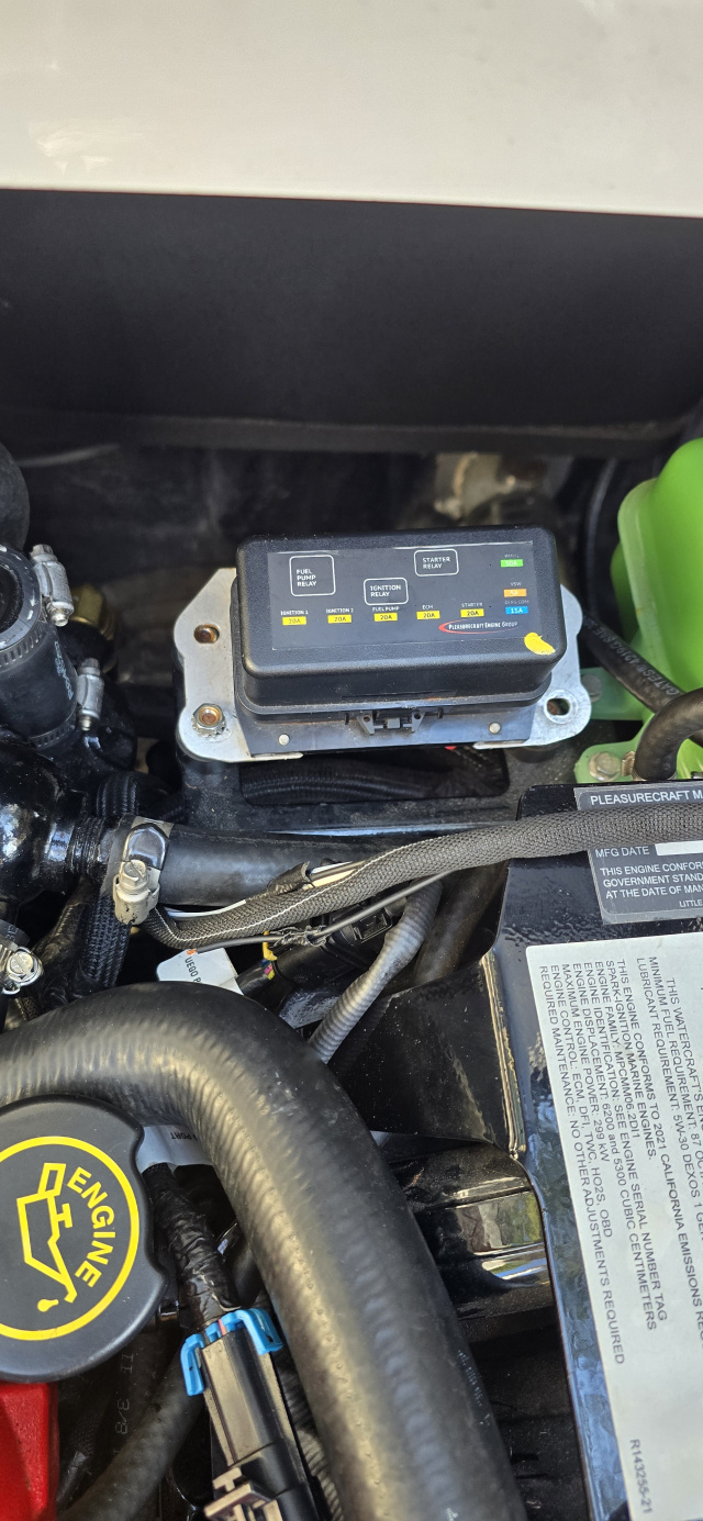

                        Click image for larger version  Name:	20250809_170453.jpg Views:	0 Size:	352.7 KB ID:	686769 Click image for larger version  Name:	20250809_170625.jpg Views:	0 Size:	282.7 KB ID:	686767 Good news, I've solved the problem. ECM fuse showed 3.4V. The wire (power supply side) had a loose/bad connection. I put a 12v wire from the nearest fuse to the ECM fuse and the ignition started to work again. I will start trying to find the bad wire this weekend. If you guys know where the bad wire is located at, let me know to save my time, want to go surfing Thanks.

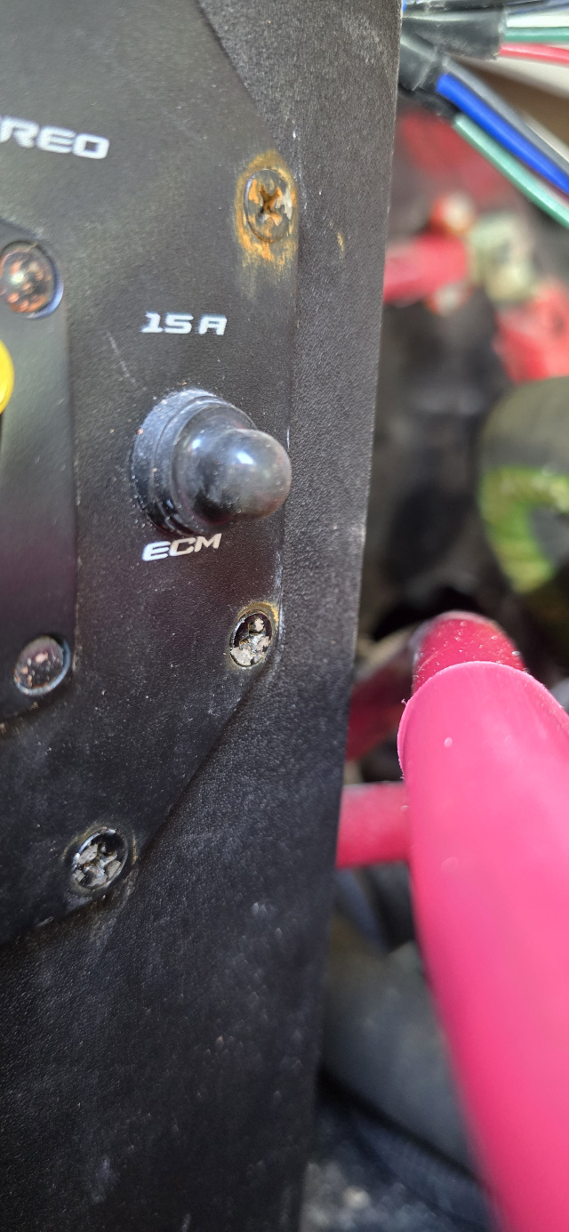

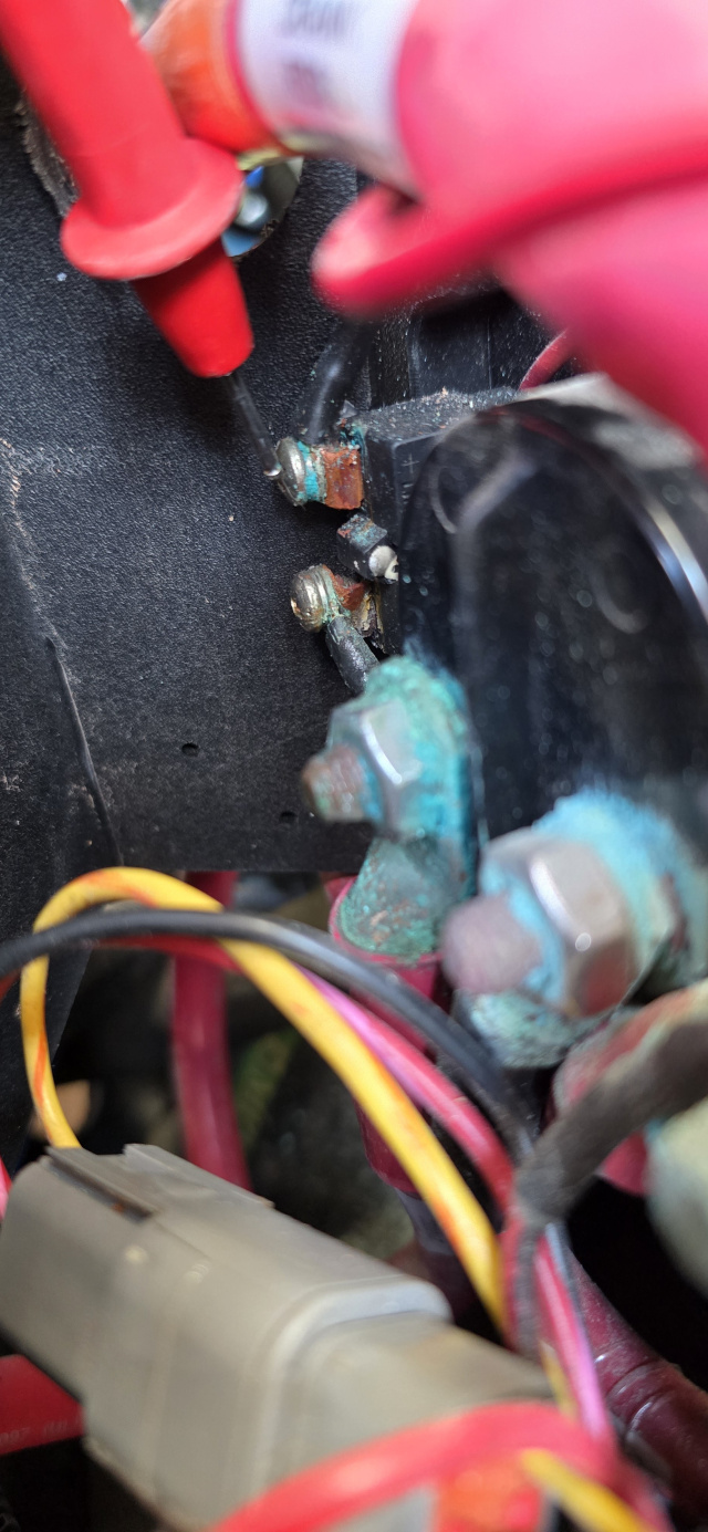

ID:	686762 Click image for larger version  Name:	20250809_173737.jpg Views:	3 Size:	317.4 KB ID:	686760 I traced the bad red wire to the battery switch box, 15Amp Circuit Breakers with Push Button Reset, the problem was in the fuse which was causing the loose connection.
