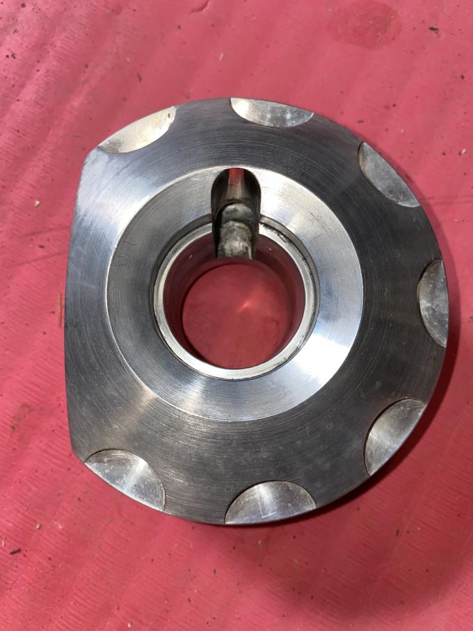

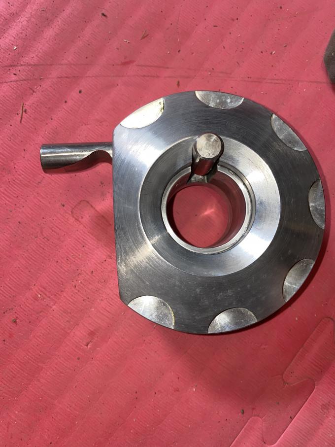

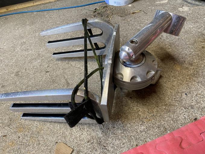

For anybody interested, there were a few areas needing addressed. The actuator pin was not moving freely in its bore, so needed cleaning, but also there was a small lip on the pin that required to be filed back plus also a lip on the aluminium housing that needed filed too. Once complete the pin moved through its range of motion so just a case of lube and reassemble. A few pics for info.
In terms of disassembly there is an allen screw that holds the upper and lower half or the large shaft (not pictured) together so a simple repair should anybody else have a similar problem.
