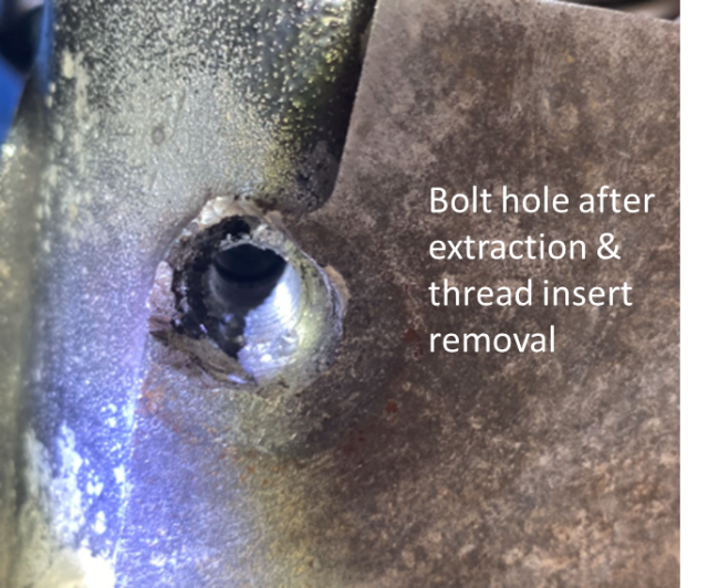

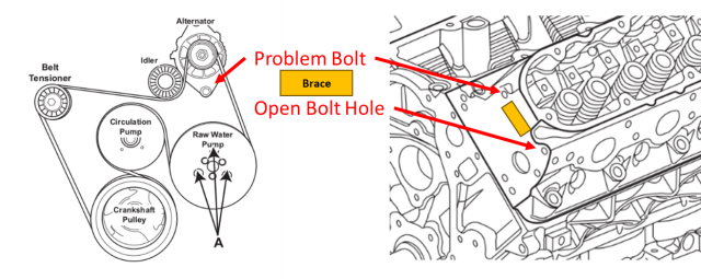

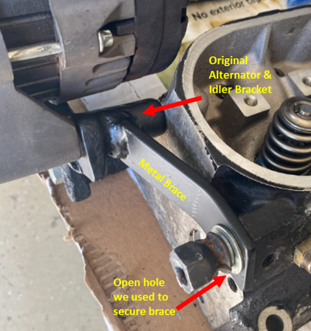

Earlier this year I shredded 2 serpentine belts before realizing my alternator bolt was sheared off in/at the block (2007 ZR6). I replaced the tensioner, idler and raw water pulley prior to this realization. After getting the rest of the bolt out, I needed to rethread the block. This didn't go completely as planned as my EZ Lok thread insert had a tiny bit of play after inserting & a 3 day cure. In order to fix this, the block will need to be filled & rewelded as there is no room left to bore a larger hole.
