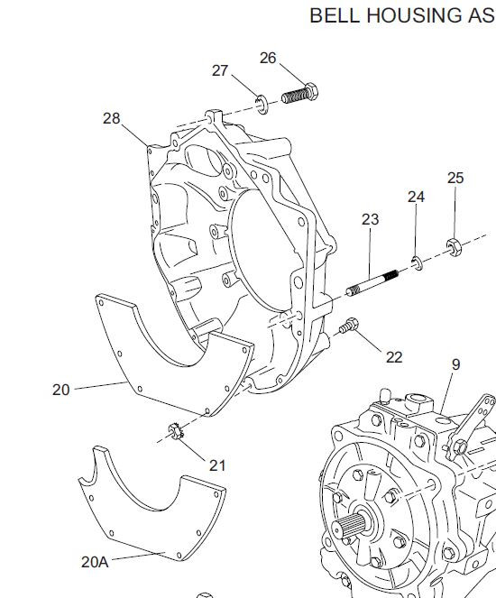

                  Ryan, I would definitely be curious if your SV211 came with the cover. It's pretty hard to access but with the starboard partitions out you can just shine a flashlight towards the bow of the boat and clearly see the flywheel/ring gear at the bottom of the bellhousing. Just seems odd to me. I found the parts in the PCM 06 part guide, picture attached. In my case the starter is at the bottom so I "think" 20A would be the one that fits. Parts would be as follows:
                  • Transmission dust cover – R019008A (starter on bottom)
                  • Nut – RS1079
                  • Bolt – RS0256
                  If I had a template I could get one laser cut like what JHoffy suggests. But if I could find the PCM part it would not be very expensive. Still pondering......

                    That certainly looks like it would be a 2 person job with plenty of fiberglass cuts, scratches and sore muscles from all the contortions that will be involved trying to maneuver that plate in place then getting the fasteners installed. Might also require disconnecting the coupler, loosening the motor mounts and seeing you can somehow get something like a jack on the front of the motor to angle the motor up to get better access to the bell housing. Anyway you look at it I don't see any joy in this job.
