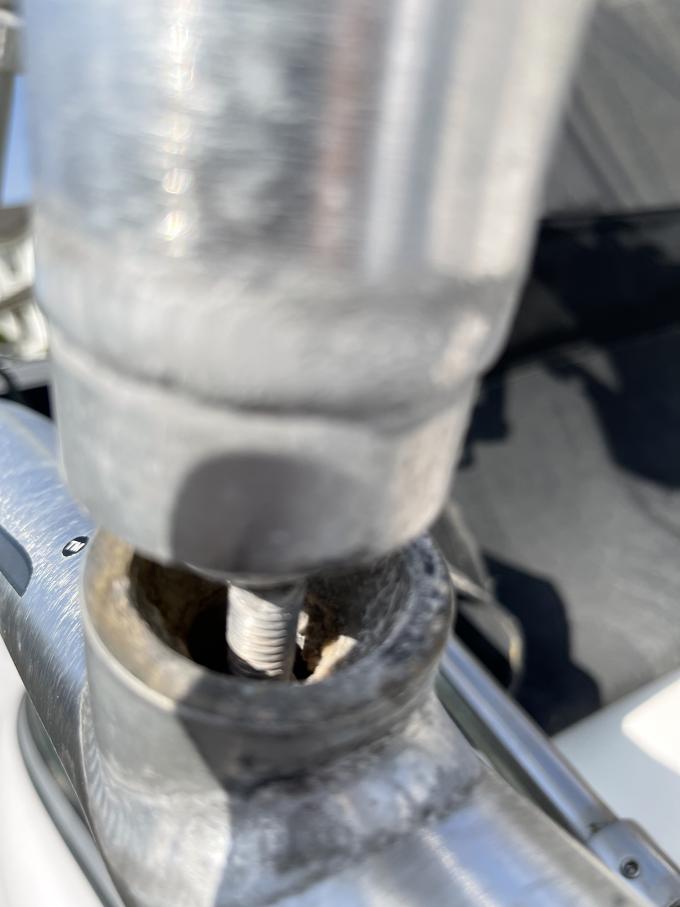

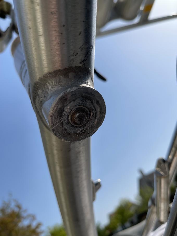

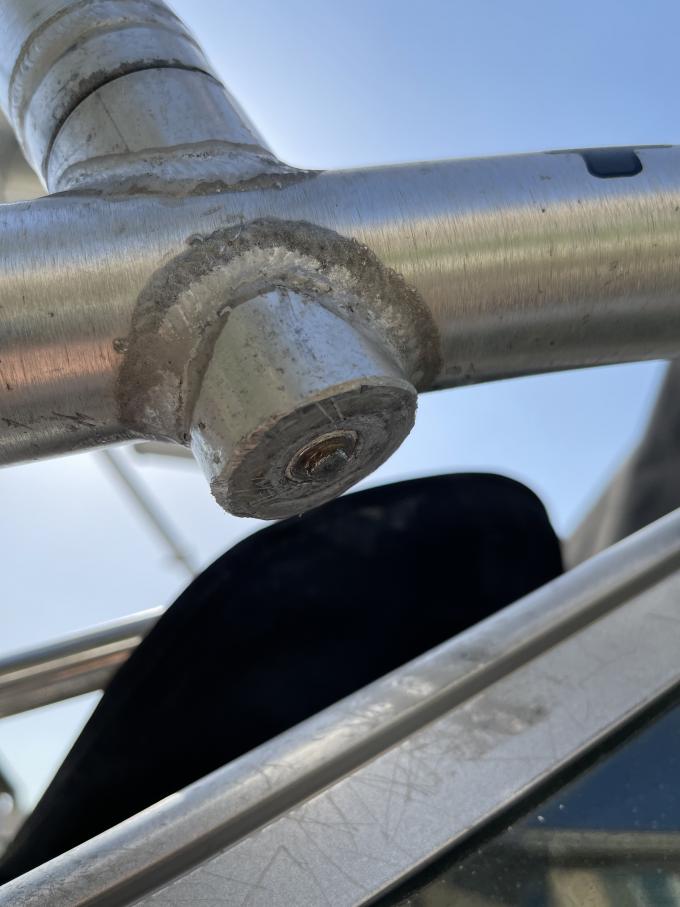

                    Okay- definitely need some help here! Got one side to break loose! The other side was a disaster. See photos. The screw broke. It’s not free either. Any suggestions? The pictures show the messed up side with the screw broken off and the other side that’s free… Click image for larger version

                      Is the last pic also the side that is broken? If so maybe you can get a Dremel in there with a cut-off wheel to cut the bolt so the tower will at least be free. Then you can drill out the remaining bolt in the tower and insert a helicoil.
                      If not then I'm afraid you're only option may be to drill out the bolt through the lower part of the tower until it can be folded over to then drill out the bolt and helicoil. That will suck because of the angle and that SS bolt will not be fun to drill! I don't believe you'll have enough meat to get a vice grip on there.
                      Maybe you can get lucky by just drilling the bolt enough to use an ease out tool… would be a better option to try before drilling the entire bolt out. Either way you have you work cut out for you!
                      Is this bolt in a salt water environment? Based on the look of the tower and welds it's got some corrosion that looks like it. Probably why the bolt has seized.

                            If that last photo is the broken side, Put a piece of wood in the gap to hold open and then use a reciprocating sawzall with metal blade or a Grinder with 4” cut off wheel to cut the old bolt in half, fold tower, Then remove old bolt halves with vise-grips then lube and replace bolt

                              The 2nd, 3rd and 4th photo is of the messed up side. The first and last are the other side that we were able to do correctly. Yeah, we bought this boat from someone who had it in the bay. A complete rust bucket!!!
