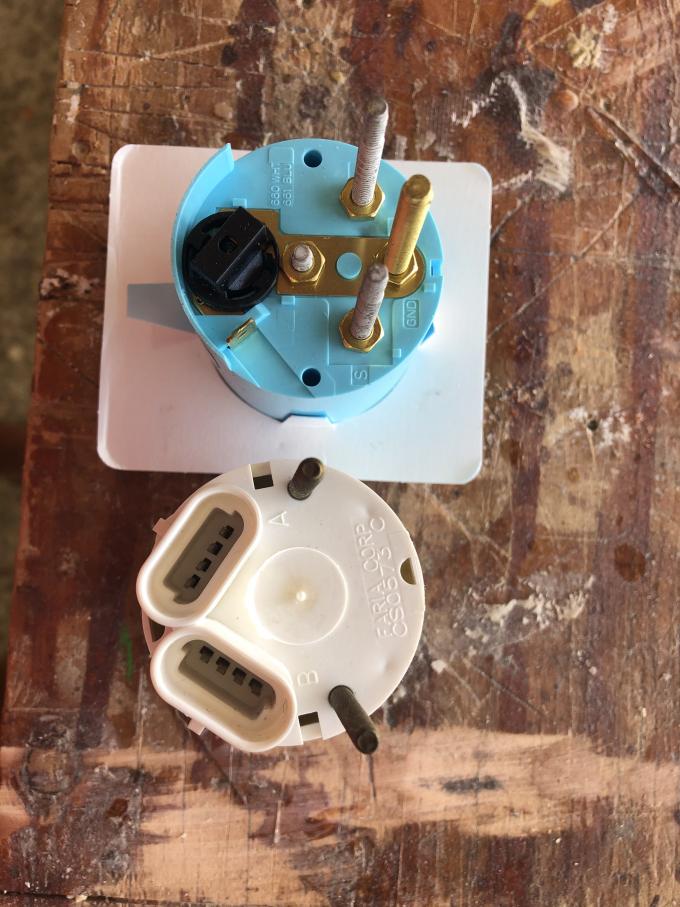

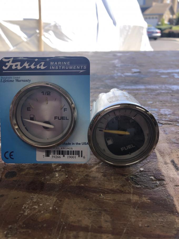

I have a bad Faria fuel gauge in my 2005 SAN. I tried replacing the sender but that did not help. I sent the gauge to Faria for them to overhaul but the sent it back and said they do not support this gauge anymore. I bought a Faria 19001 Kronos gauge to replace the old one but it has 3 posts and a blade connector for backlight instead of the 2 plugs with 4 prongs each that the CS0573C has. Does anyone know how modify the wiring to make the new gauge work?
You can't.
Your gauge uses a serial connection from the Faria gateway. The new one connects directly to the fuel level sender in the tank.

I called Faria and talked to a tech., he said I could use the new gauge but I would have to run a wire from the Gateway box (in the starboard aft locker) to the gauge and might have to switch gauge location to put the new fuel gauge at the end of the series. I’m having my steering cable replaced so I will probably have him run the wire for me.

I am going to run two wires from the sender to the newer style fuel gauge. The new gauge has 3 posts one for ground, one for sender, one for switched power. I will run the ground and switched power from the power outlet on the panel. I will report back how it goes.
