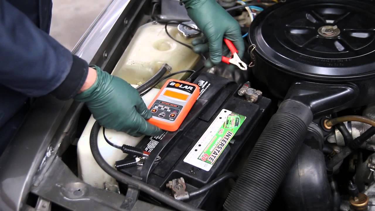

Anyway if you want to learn more about battery testing here's a real good video that will educate you quickly on battery testing and testing options.....
