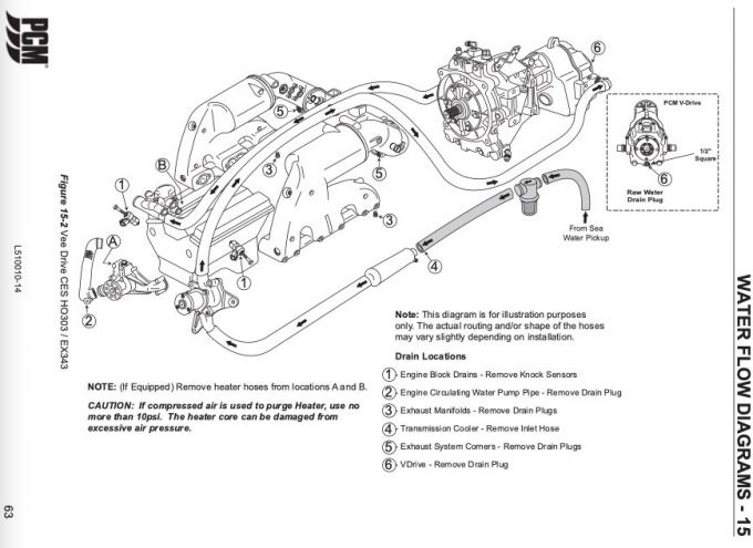

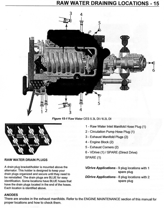

2016 210. No heater. Have the freshwater flush system installed. Is there any reason why I could not/should not use a compressor, connected to the freshwater flush connector, to blow out the freshwater cooling system to winterize?
