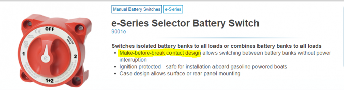

                    I think i read that the battery switches are : Make-Before-Break (MBB) is a term “Denoting a switch or other device in which a new electrical connection is made before the existing one is broken”. In short, it simply means, shorting the circuit before disconnecting it.
                    So you ok to switch from/to any of the on positions. But you don't want to turn it off while boat is running.
                    Also, that being said, I would just put on both (1+2) and leave it there unless sitting with boat off listening to music, and then just move to either one or two. Leaving the other one isolated for boat restart. This way you are using both to start and topping off both all the time while running.

                      The way these switches fall apart I'd prefer to be safe and turn the boat off before switching if that's an option.

                        Whether it is or not in the manual it states to not do that. And like stated I wouldn’t want to test it when it’s not necessary. When starting and under way I always just leave it on both for obvious reasons.

                          Oh, where in the manual does it say that? Can you post it?
