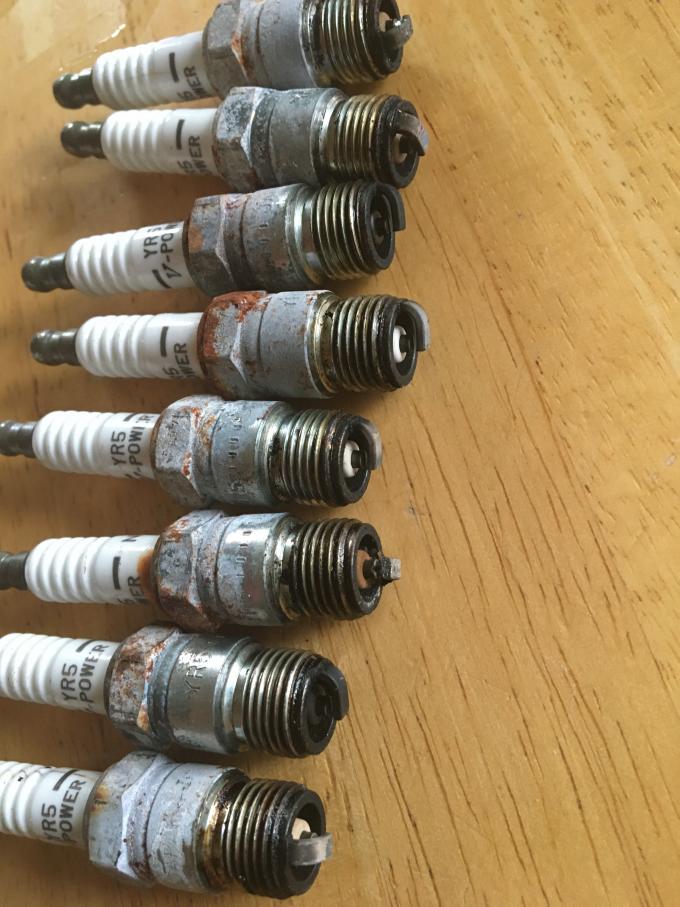

I have to admit I don’t own a Nautique, but I do own an ‘85 Ski Supreme with PCM 351 and I’m hoping someone here can help me out.
Went to fire the boat up for first time since Oct last year yesterday. Turned over strong but never fired, even with starter fluid. Not even a sputter.
Battery is good. Pulled spark plug, it was pretty black. Tried testing plug wire for spark with screwdriver against block, nothing.
Inspected distributor/points and all looked pretty clean. Borrowed neighbours timing light, and it flashed on coil wire, and plug wires.
I checked voltage at coil and it was 4.8 V with key on points closed.
I’m thinking i have weak spark and was going to head back to lake with one of those spark tester devices to see how strong the spark is (along with a new set of plugs).
Do you think fouled plugs could cause no spark/start issue? I figured you would get something going, but maybe just rough. What are the chances of them being all bad?
Any help would be appreciated!!!
Thanks!
