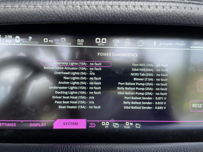

      Akeap I checked my ballast sensor voltage today on my 2017 G23 and they are all in the .80 range. If I see any red flags with your voltage above, it is the sensor reading +/- .40s. Here is a picture I took today in my boat so you could compare. Click image for larger version

          One of our drivers has been talking to our dealer and they suggest that it "might" be a lazy pump, but I recorded the voltage whilst filling for wakesurf right last night and the voltages were moving and a percentages on belly and port but the stb voltage was static and showing 0% so I assume there is something up there. We have a spare pump and I will fit tonight or tomorrow morning. Will update when I can.
