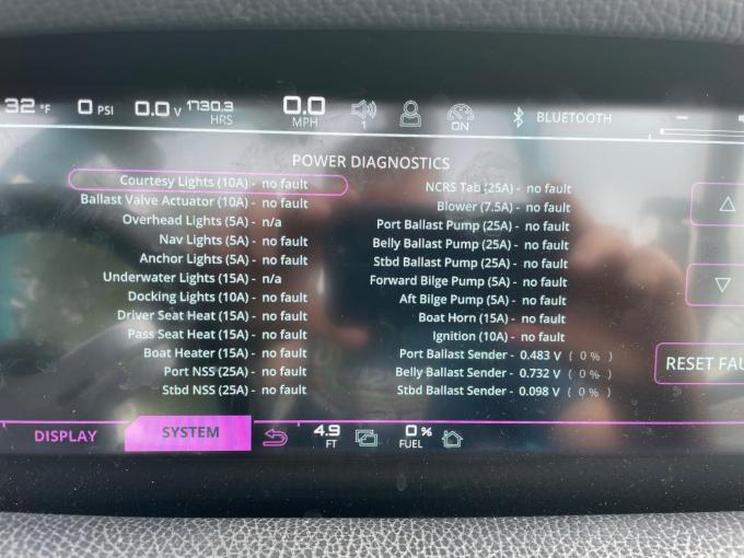

                      Sorry to jump on this post but I have a similar problem where the starboard tank on a g21 seems to not be filling or emptying properly. I have checked the impellor of all pumps and seem ok even replaced the starboard one but problem still persists.
                      Do these voltages look correct?
Name:	Ballast voltage.jpg
                        Do you really have 1730 hours on your G21 2018,? Had to asks, seems high. I will check my voltage on my G23 2017 senders and you can compare. Your Port seems low

                          I don't know about the 3 voltage items at the end, but the amp numbers are probably the amount allocated in the pdm (power distribution module), and not a reading of how many drawn.
                            Hmm I will carry out some checks whilst draining and filling and check the voltage tonight.
                            In regards to hours yes it is true, but this is a boat at a members club where it gets used everyday from March - end of October and lots slalom skiers are taking up surfing as they get older and the poor ski boat isn't used as much! but that means less time for us wakeboarders!!
