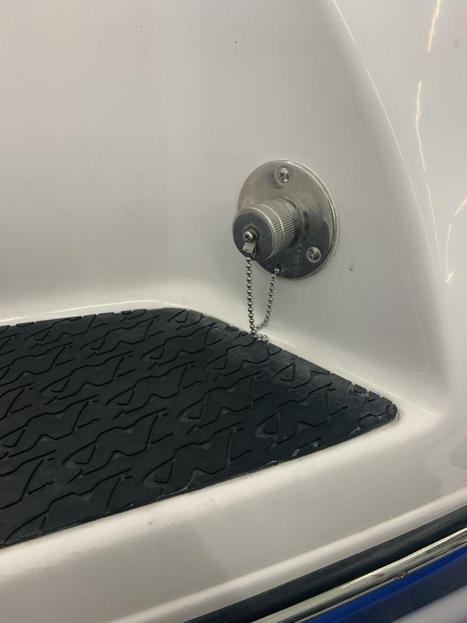

Boat is a 2007, no answer for why i put 2006 as the topic question, age is what im going with. Looked in the manual, online etc. etc. Im thinking its either a hot water shower port or a hose hookup to run the boat out of the water. Its in the step on the left side of the boat at the rear where you step up or down from the platform. Its stainless and looks like a hose would attach to it. Can't believe i cant find out anything about it but either way lets ask the experts on here, im sure someone knows. Thanks in advance for any answers!
fake a lake fitting for connecting to a standard garden hose. you will have to trace the plumbing however, because there *should* be an inline T valve to flip from lake to hose and back. there may not be, but there should be.
Yep, definitely a port for flushing the engine / running it out of the water.
I always order this option on my boats. It makes winterizing very easy.Please do not PM me directly asking for advice on how to repair your boat. While I would love to help everyone, I simply do not have time to respond to all of the inquiries. Please post your questions on the forum, so that all of our members have a chance to answer.
Thanks, i was hoping that was it. Im thinking i would need to close the ball valve above the normal water pickup when using this and someone else mentioned possibly another valve that needed to be shut or opened. You would think that the manual would explain this but I didn't see it. Might be looking in the wrong part of it. I printed out the water flow diagram and it does not even show it.Originally posted by NautiqueJeff View PostYep, definitely a port for flushing the engine / running it out of the water.
