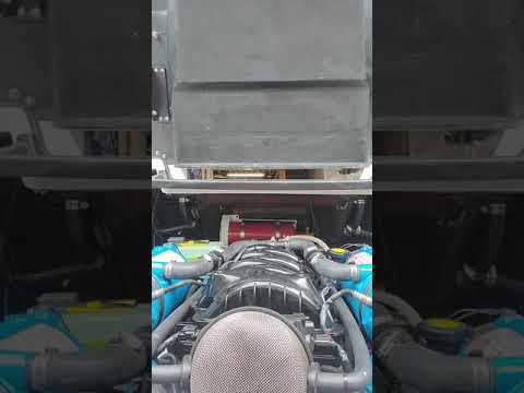

    Figured Id make a new thread as my other one was mainly tied to my alternator problem. So about a month ago I pulled my g23 out of the basement, put the raw water plugs in the manifolds, charged the batteries and thought I was ready for the lake. 3 weeks ago we take it to the marina it stays out put it in the water and all seemed well until we cleared the no wake zone. The boat would run up to 2500 rpm/9-10mph no problem. However once it was under load it would start popping and struggle to run until you brought the throttle back down to below 2500rpm. I thought ok, water in the gas and its fine. Took the filter off drained it 4-5 times, drained the fcc twice and tried again with same result. We spent a good 2-3hr on the water just trying to burn the fuel so I could refill but the alternator had other plans. Batteries drained down to 6.6v per the screen and somehow managed to make it back to the marina. Alternator and fusible link/cable and battery was replaced so that problem is solved. Fast forward to present time and I still cannot get this boat to run correctly driveway on the hose.
    Symptoms are: Its hard to start meaning it takes 2-3 presses of the start button before it will run. With any normal throttle speed it will not rev over 2500rpm. Once you cross that point you get popping sounds and it wants to die until you throttle off. However if you ease into the throttle slowly it will rev up just fine. (cant say what it does under load this way).
    So far I've done the following:
    - Syphoned 53gal of dark colored gas out of the tank, replaced with 15gal of fresh 87 (gas gauge shows 0% maybe unrelated)
    - New spark plugs
    - New fuel/water separator
    - New HP fuel pump
    - New FCC filter Kit
    - New Alternator
    - New 125a fusible link
    - Pulled the separator off after running for 30min and no visible signs of water in the bottom of a clear glass
    I've called two dealers in the state that work on Nautique and all are 6-8 weeks out on repairs. Thus the reason I'd like to sort this out myself so we can at least get some use out of it.
    See below for a video of issues:
