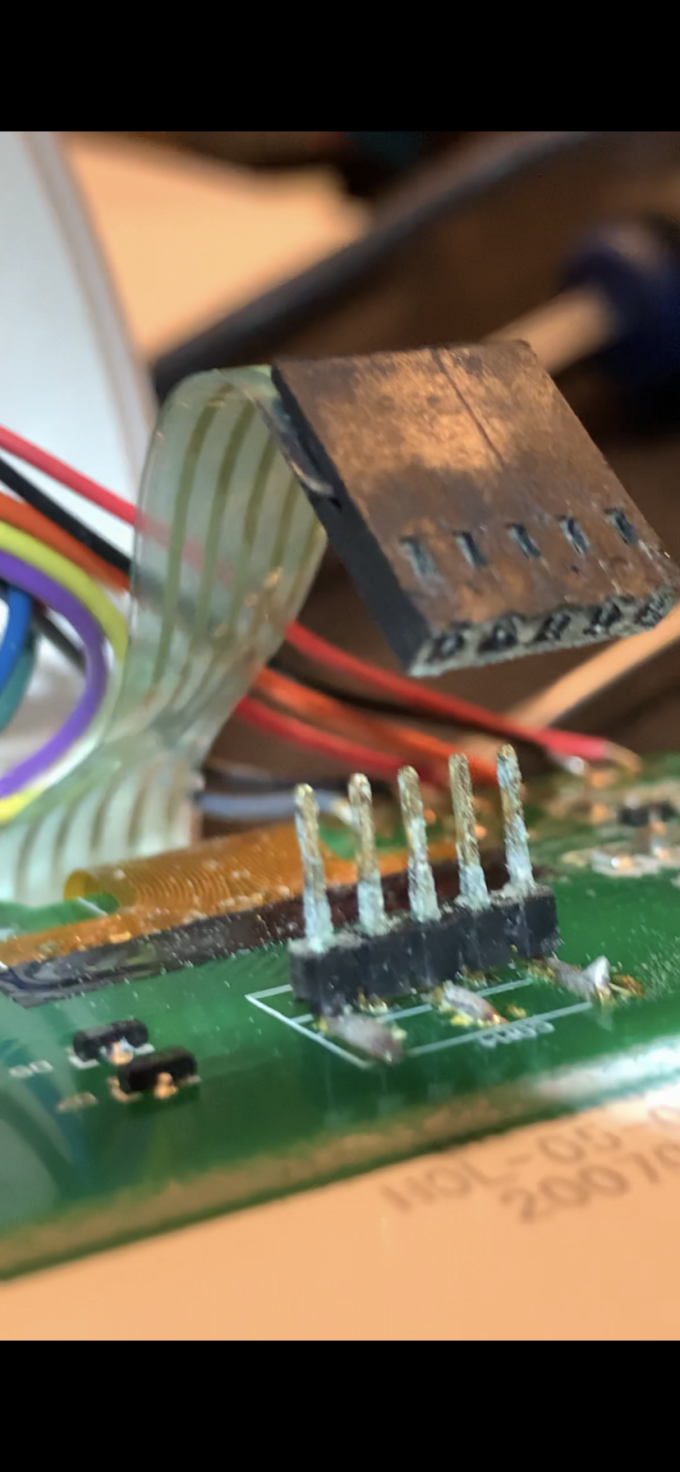

LOL - I also have the 2006 220 SANTE and I'm working on the PP this weekend too. Mine is a button problem and not a display issue, but I've had the display issue. I have quite a fe PP displays that I've played with over the years and some have a pressed on chome bezel and others have one that can be pulled off (Interestingly enough, I used biacs same ides to pry it up a bit and then insert zipties into the gap - weird we both had the same obscure idea. I also used silica packets to suck up the moisture!). I noticed that on mine (wakeboard pro - multi line), the ribbon cable that connects the display and buttons to the logic board was very very corroded and I think that is my issue (I will know tomorrow). I sanded off the contact points and cleaned it all up and added some dielectric grease to keep good contact. I created a video I need to edit and post - stay tuned.

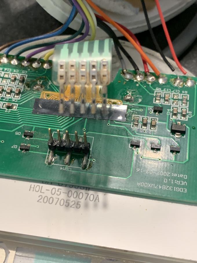

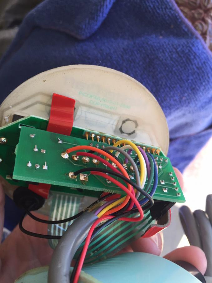

I called PP today to ask them some additional questions (I have a few of these displays in various states of repair) and I asked them your specific question about using MC or Malibu. He said as long as the physical circumference display is the same, you should not have an issue swapping between "brands" (he even speculated that the wakeboard pro display would work on the guts of the older multi-line unit as well). However, this doesn't look to be plug an play. Take a look at these pics - one is from a MC forum and the other is my PP in the Nautique. The physical display on the MC is a single-line so consider that they could be very different than my multiline an it could be easier than this). As you can see, the wiring is the same (same number, same colors, same order - zoom in really close on the MC and you'll see the brown wire is there). But, from what I can tell, you would have to solder your wires on the MC display to get this to work. I can't say this would give me no anxiety plugging it in the first time either...I'd try to find a broken Nautique one myself. Or maybe try it on your friend's boat
