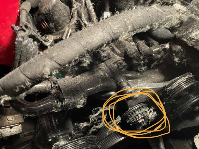

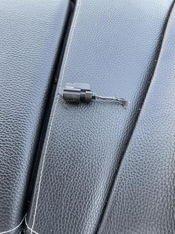

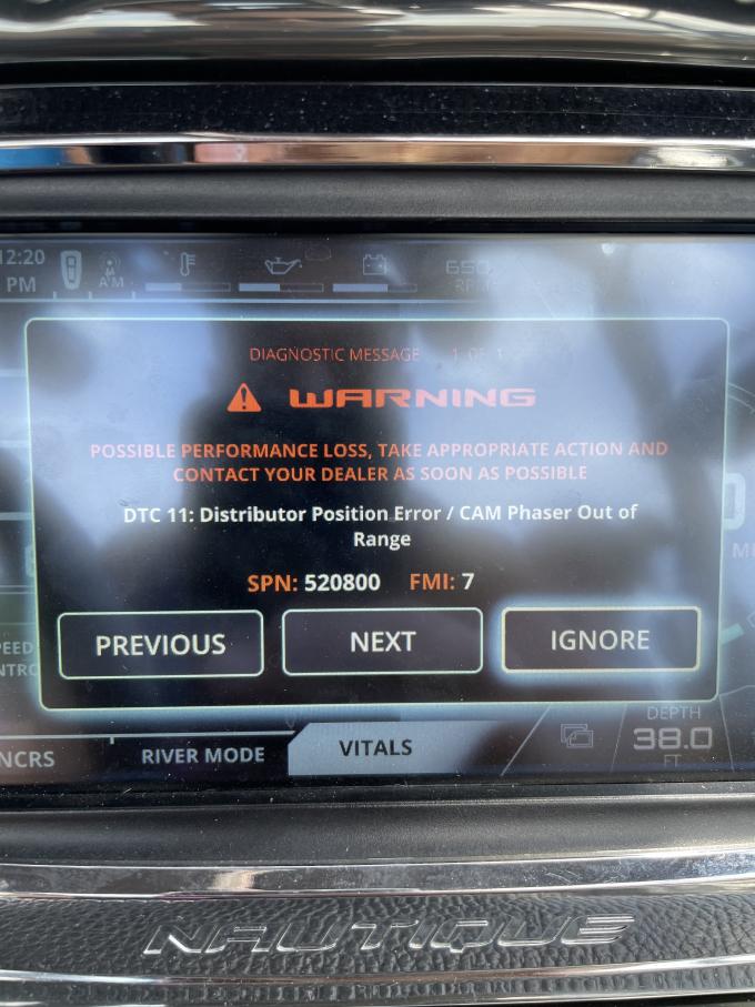

    Serpentine belt but the dust last time I had the boat out. Had to replace a busted idler pulley too. Apparently the broken belt took out the cam position sensor. It was throwing code DTC 11 distributor position error any time I tried to go over 10mph. Found a broken connector in the bilge in the aftermath. I assume it’s the cam position sensor. I haven’t been able to find a good diagram. Anyone know exactly where it is located?

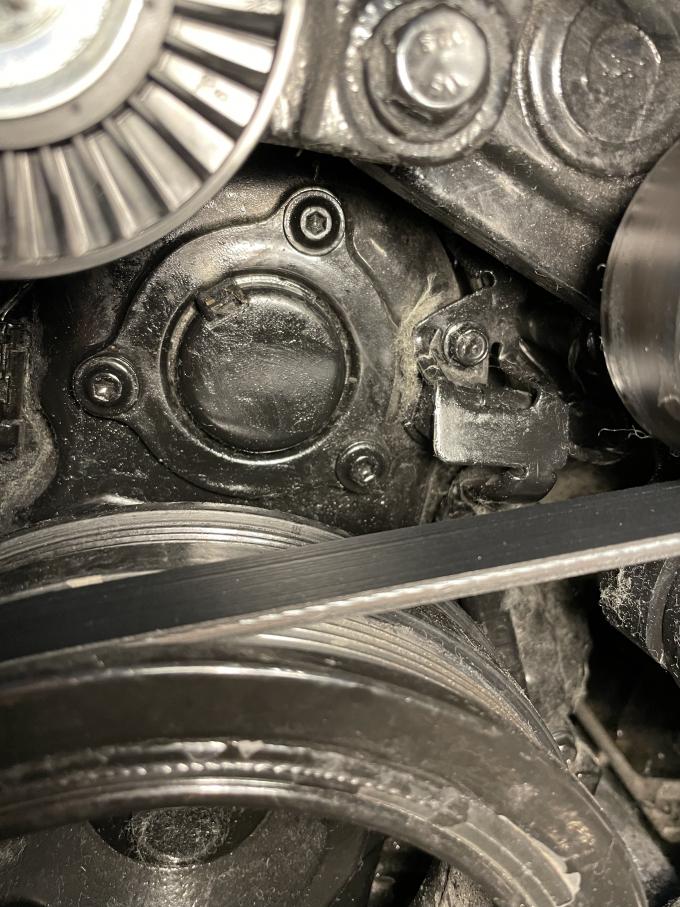

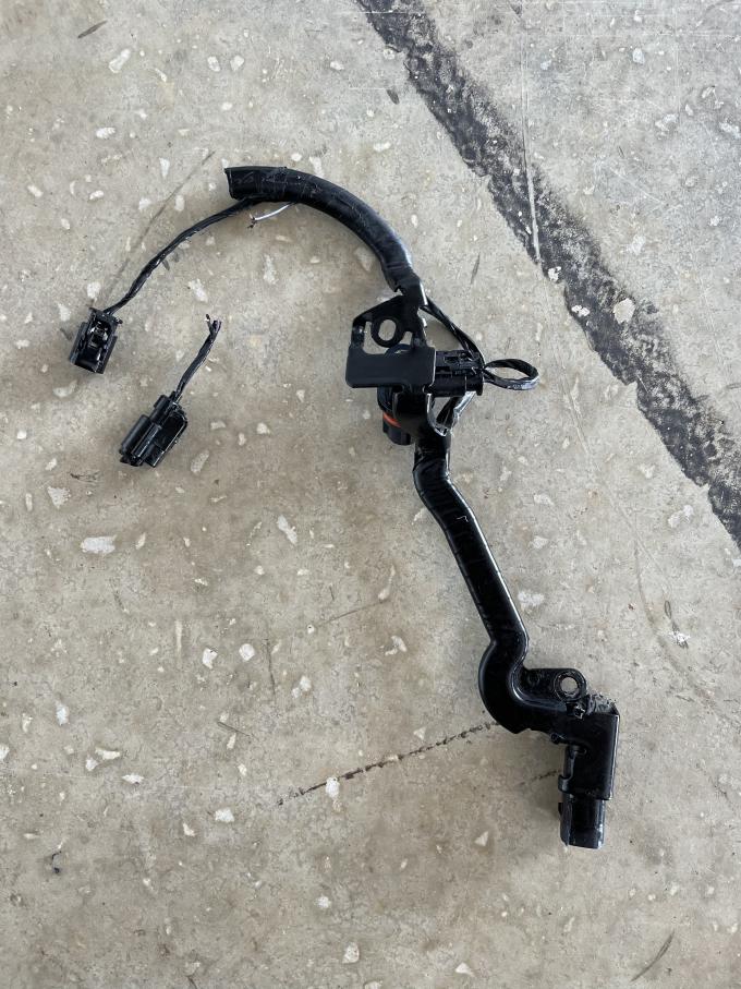

    12670340 is the Gm part number. Had to pull the wiring harness off the engine and reattach the connector.

      Just by looking at it, I can tell you that it is a cam position sensor harness. It’s the same as a Chevy 1500 with a 5.3 or 6.2. I’ve had to replace them. It’s located behind the crank pulley. When they do go bad the power control module code on Chevy trucks is P0011.
      It’s not the easiest sensor to replace!!!

        I was able to get a technician at work to repair the harness. Boat ran fine after repair, but now I have a major oil leak from the crank pulley. I guess the belt remnants tore up the crank seal. Replacement doesn't look too bad but can't get the parts until at least Monday.
